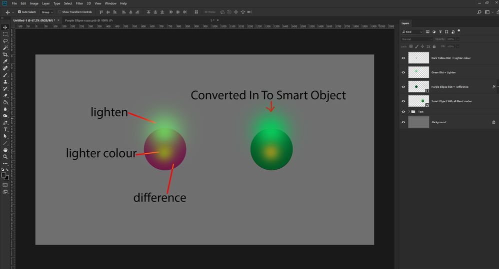

Here's a better example which could shed more light.
On the left as you can see is some brush blots, with an ellipse shape. Each have a blend mode applied.
Once I select them all, and make it into a smart object, it transitions into losing it's original appearance. I'd like to be able to make smart objects which have different blend modes applied to them without losing their initial appearance if it's possible.
Thank you.

I see the image you posted but I do not see the documents layers and which layers you converted to a smarts object. Did you target all layers and layer groups in the Document to make your smart object layer?
Copy link to clipboard
Copied
Here's a screen shot of the layers which are targeted.

The way a smart object works is to blend its layers internally then present the resulting blend as a rasterised image layer in the main document, whilst retaining the editability. That of course can have a further blend mode applied to it.
In the case shown in this thread the bottom layer of the smart object is set to 'difference' blend mode. But inside that smart object that bottom layer has nothing to blend with. So of course it looks different to the separate layer whose difference blend mode is blending with the grey background.
To make them look the same, an additional layer is required as the bottom layer of the smart object. This would need to be the same shape as the circular disk to retain transparency across the rest of the smart object.
Dave
