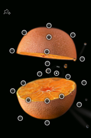

2. Use pins and field blur
Alternatively -  you do though. take a look at Field Blur using multiple pins, and see if it will give you the output you need . It varies blur in a smooth way and, although not using the painting method you were asking about, it does let you control the blur at different points that blend into eac

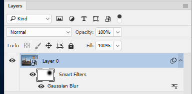

You could put your image in a smart object. Apply the blur to the smart object then apply your mask

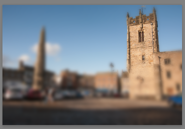

As you notice on the first picture you got the sharp picture in the back, and the blury one above. (I actually tried your tipp here with the smart object). But as a result you get a messy transition vom sharp to blury.
On the second picture I used the Tilt-Shift filter to show the wanted result.
Alternatively -  you do though. take a look at Field Blur using multiple pins, and see if it will give you the output you need . It varies blur in a smooth way and, although not using the painting method you were asking about, it does let you control the blur at different points that blend into each other - just keep adding pins to build up that variable blur.
Quick and dirty example below
Dave
