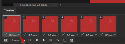

November 6, 2022
Hi @Jon269864278sog In addition to the great explanation from @Myra Ferguson on using the video timeline, here are some screenshots that might be helpful in adjusting the frame rate when you want to output an animated GIF in Photoshop. Here, it's called setting a frame “delay” instead of a frame rate. Click the little down arrow below each frame where the seconds are shown. That brings up a menu with some preset times, or choose Other... and set your own delay time (up to 240.00).
November 7, 2022
Thanks very much to both you and Myra. However, it looks like this option will only help with slowing down the frame rate. If I set the delay to '0' the frame rate on preview and in exported gifs still seems to be capped at, I would estimate, 30fps. The 'convert to video' route seems to be the way to go to increase the frame rate.
