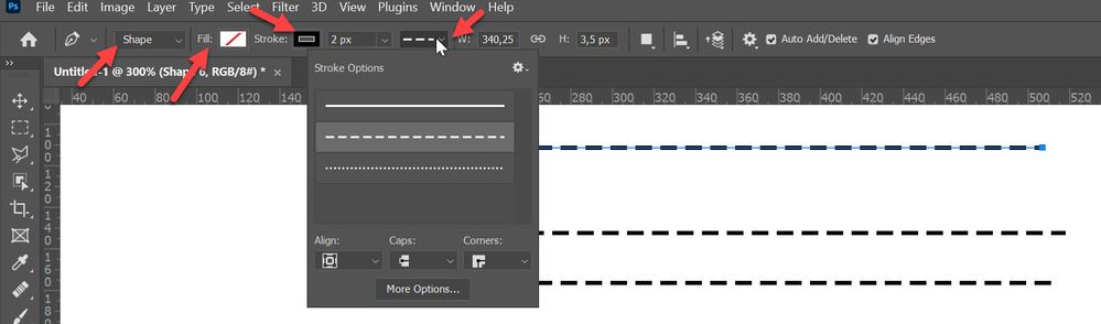

Try using the Pen Tool. Set Fill to None, Stroke to desired color and Weight and finally set stroke to Dashed from Stroke Options drop-down. Click then Shift click one more time for straight line.

Thanks. This was helpful. I misread it at first and tried it with the Line tool. For some odd reason it still keeps defaulting to 59 px for the height (even though I deselected Link Shape Width and Height). I think by disabling the fill, it let me change the size in the Properties window. It still had marching ants but when I pressed Command D the marching ants stopped.
I then re-read your post and went back and tried it with the Pen tool. It also worked but I had to Shift click the end point to "close" the line and Command Return to view it. From there I could play wth the stroke size for different effects.

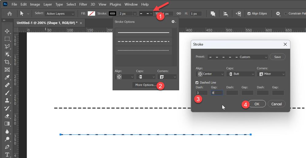

Any tips on how to create a custom dashed or dotted line? Is there a standard for setting dashes and gaps? I just did some random sequences but can't really tell how to create more space between the dashes.
Jan 12, 2023 Jan 12, 2023
Select line then click on Set shape stroke type in the Options bar (1). Click on More options (2). Type Dash and Gap (3) then confirm on OK (4)
