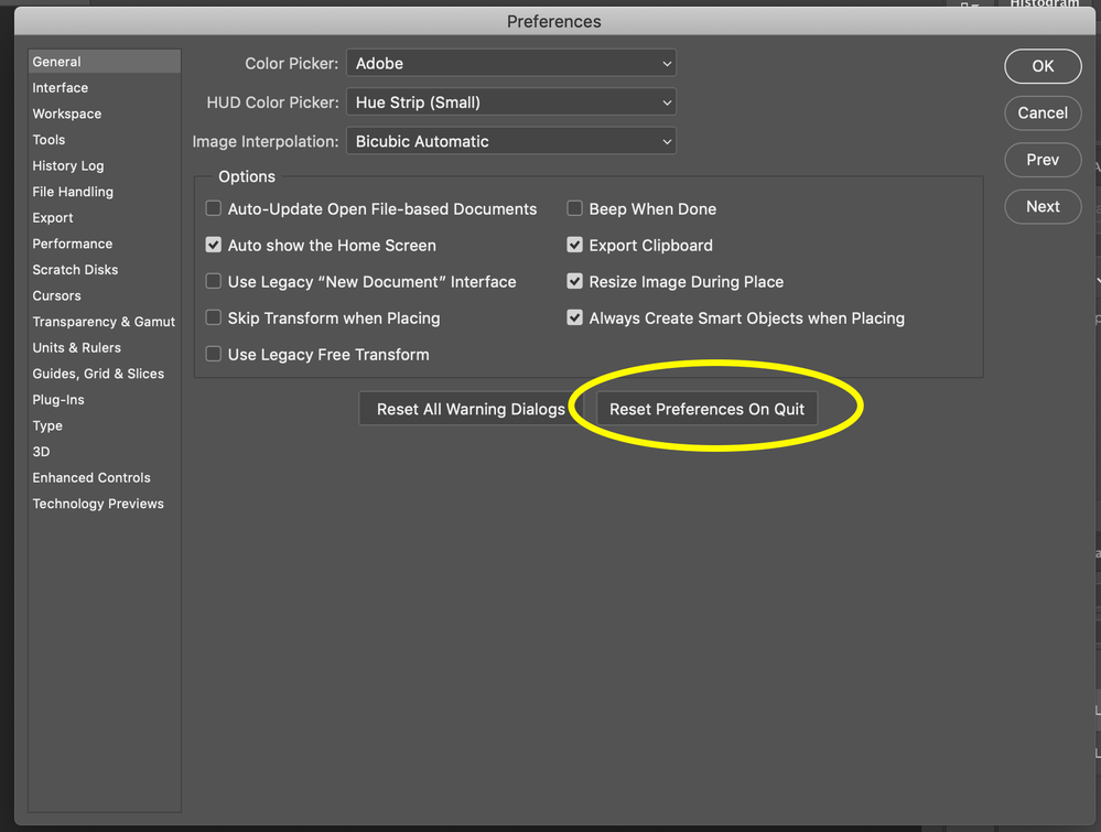

Also, did you try resetting your preferences from Preferences -> General -> Reset Preferences on Quit (as in screenshot)

or you can Reset the preferences by following steps on the below link
https://helpx.adobe.com/in/photoshop/using/preferences.html
Let us know if this works for you.
