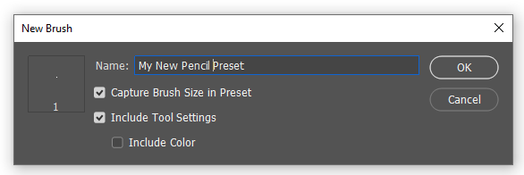

New Brush Preset from the Brushes Panel’s flyout menu (edit: or the »Create new brush«-button)
