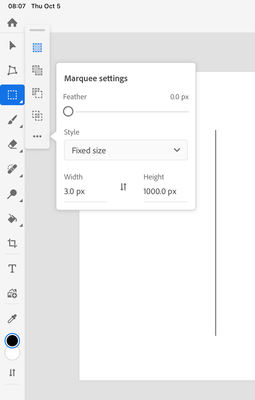

@Jeff Leese
This is a very awkward work-around for PS on the iPad, and I wouldn't want to do it more than once or twice in an image.
  • Set the Rectangular Marquee tool to Fixed Size and type a Width and Height
  • Click and drag to create and position the Selection marquee
  • Fill with the foreground color (Option+Delete or Paintbucket)
  • Deselect
  • (Reset the tool if necessary)

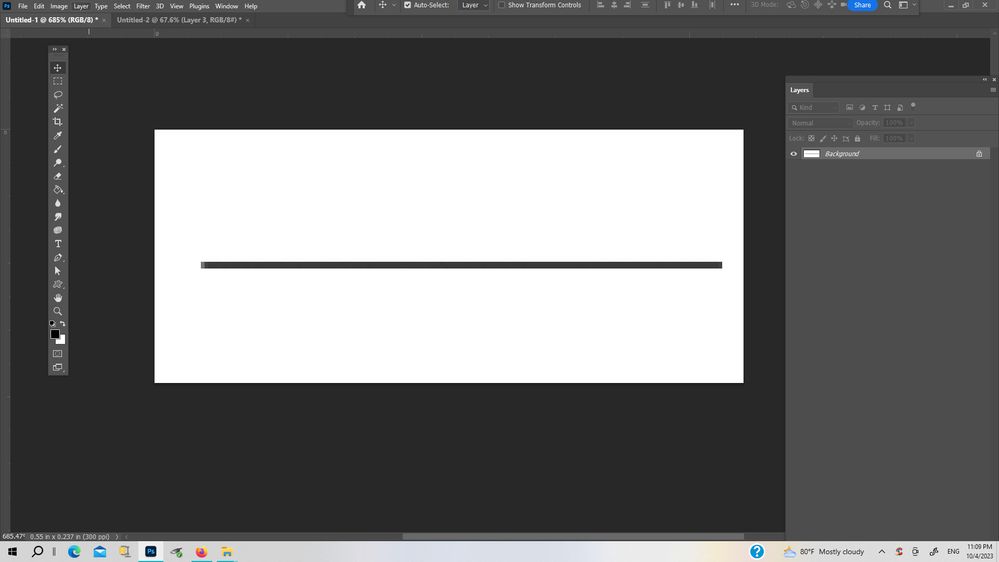

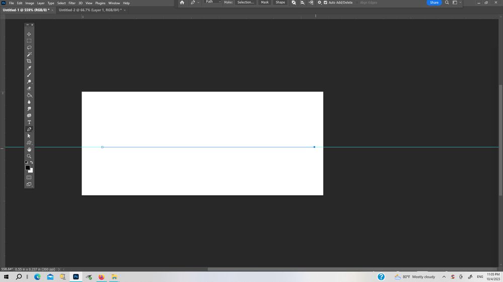

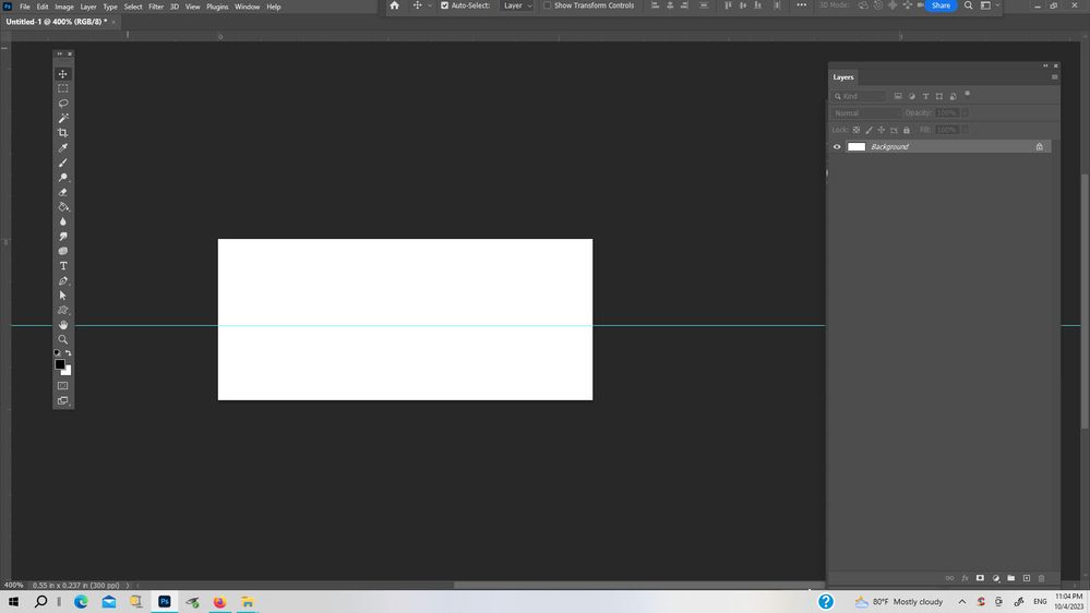

Oct 04, 2023 Oct 04, 2023
If you mean the Pen Tool, do this:
-Set your brush to the desired thickness
-Drag a guide to where you want your line to be
-Place your points along it to the desired length (or height if it's vertical)
-With the Pen Tool selected, right-click, and from the dropdown menu choose Stroke Path.

@Jeff Leese
  • Deselect
Jane
