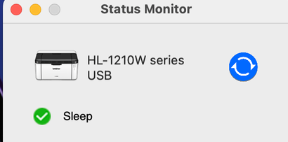

I don't get why green check Sleep. Refreshing with the blue button the printer light blinks.

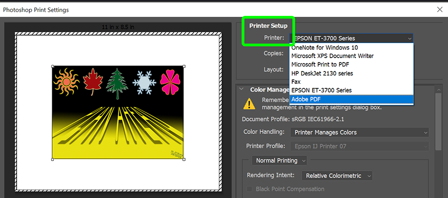

Printer Settings > Printer drop-list gives me the option to print to Adobe PDF.

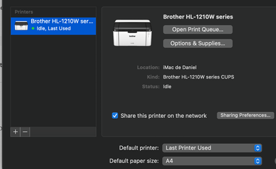

In printer setup I don't have the list you have, there's only the Brother printer available

@Marciano#1 MAC, reset printing system:
On your Mac, choose Apple menu System Preferences, then click Printers & Scanners
Press and hold the Control key as you click in the list at the left, then choose “Reset printing system” from the menu that appears.
After you reset the printing system, the list of printers in Printers & Scanners preferences is empty.
Reinstall the print driver, only from the manufacturer, not Apple.
