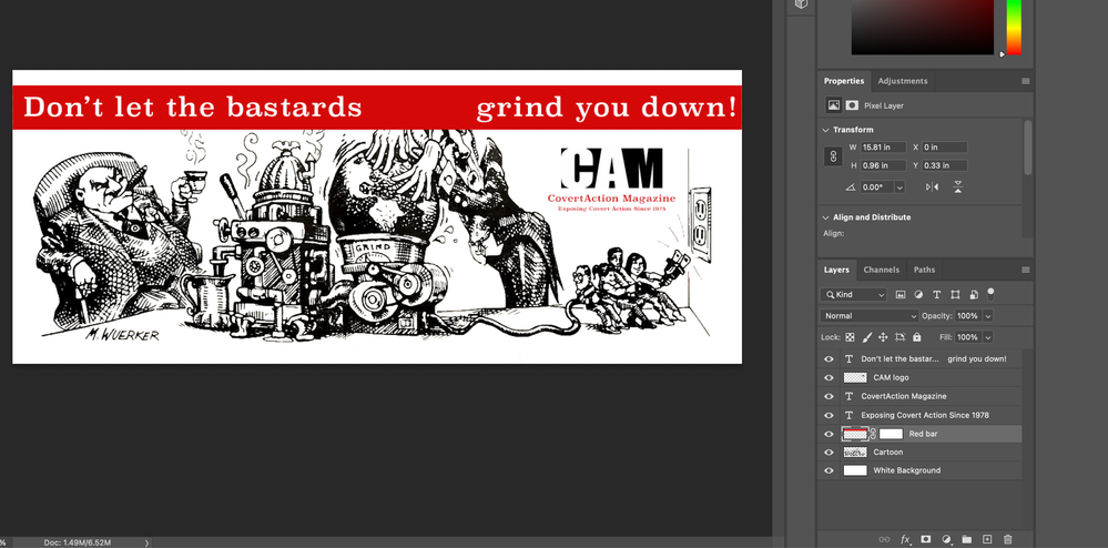

Hi All,
I hit one button or did something and it worked. Now I can't repeat it, but I'm sure it can be done.
I have a cartoon layer. Then a red bar layer above the cartoon. But I want the upper portion of the cartoon (head of man) to appear on top of the red bar layer. WHAT'S THE TRICK?
I have included pictures to demonstrate. (Note the actual mug where we originally did the cartoon some 25 years ago. HOW DO WE REPLICATE?)

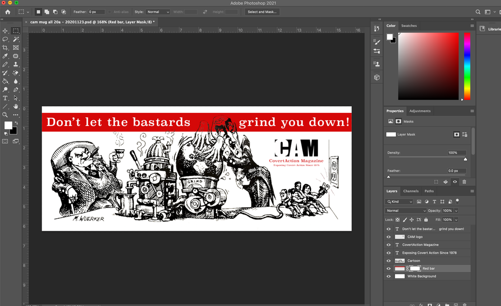

Correct answer davescm
Use a mask to cut out the red bar around the head. When painting on a layer's mask, - white shows the associated layer , black hides it and shows the layer(s) below

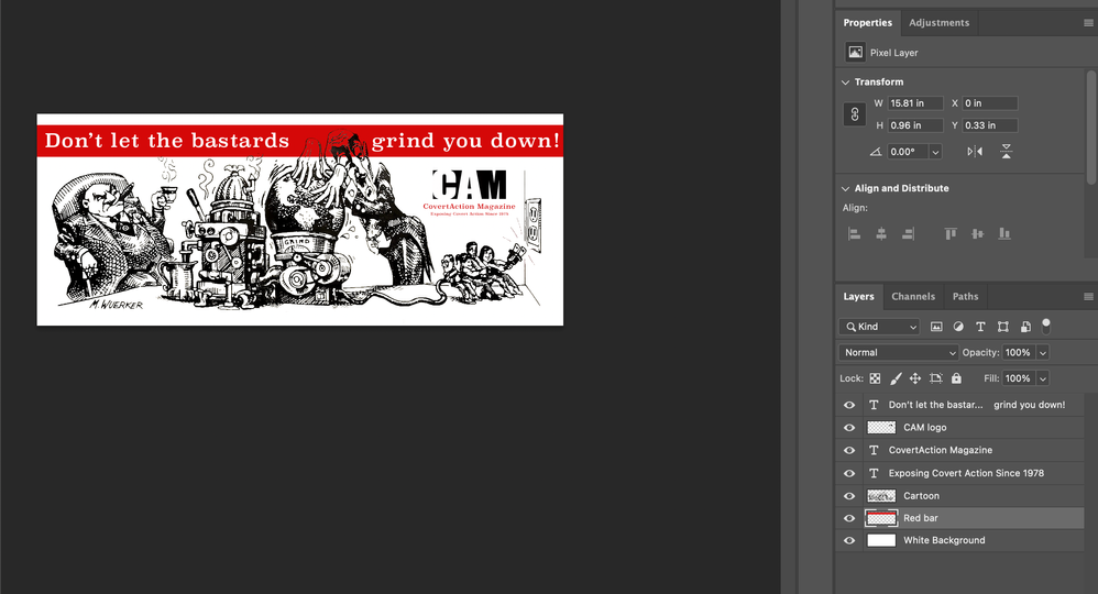

Look again at my screen shot. The red layer needs to be above the cartoon layer, not below. Then create the mask on the red bar layer and read my directions and Dave's post again.
Dave

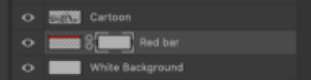

Create a layer mask for the layer with the bar.
Paint (Brush tool) with black on the layer mask (not the layer).
You might want to start by selecting the image layer and Select > Subject to restrict the painting area first, then select the mask on the red bar layer and paint with black to reveal the underneath layer.

c.pfaffenbichler
November 23, 2020
Set the linework-Layer to Blend Mode Multiply and add a white Solid Color Layer with the appropriate Layer Mask under it.
