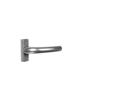

Hi there! Is there a possibility to change a metal object into white?
I have to change this handle into white.

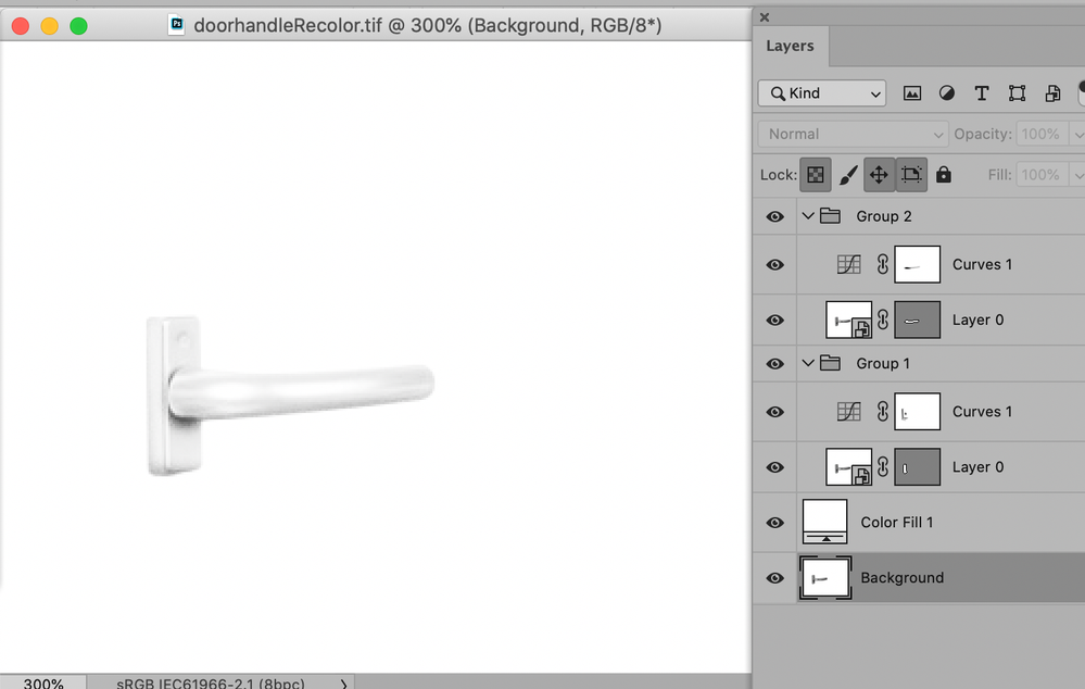

Community Expert , Mar 23, 2020 Mar 23, 2020
• create two copies and applied a vector mask to each (one for teh cover, one for the handle)
• put the two copies in a Group each and set the Groups’ Blend Mode to Normal (alternatively one could Clipping Mask the Ahjustment Layers to the two Layers)
• add the Curves Layers
• brush in black on the Layer Masks to hide the effect where it would affect the shadow too much

»metal« is in this context not a »color« so much as a mixture of surface properties (like reflexivity).
So I expect some painting may be unavoidable.

You can start with Curves Layers, but I think it would be useful to edit the handle amd the cover separately.
And then you may need to add some painting to mitigate the extreme highlights/reflections.

Thanks. I've tried it now, but don't get it like you. Is it posible that you explain it step by step to me?
