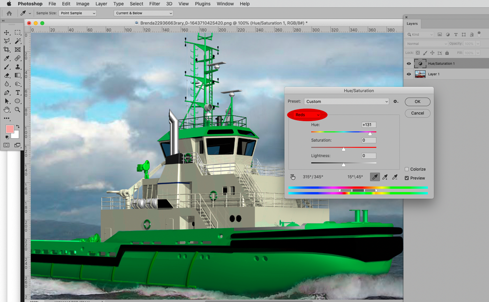

Feb 01, 2022 Feb 01, 2022
Depending on your expectations a Hue/Saturartion Layer may suffice for this.
If not you need to create a Layer Mask for the regions you want to recolor.

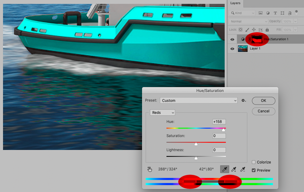

Feb 02, 2022 Feb 02, 2022
One can edit a Hue/Saturation Layer’s Color Ranges and drag the handles manually and add a Layer Mask to the Layer.
Another option would be just using a Solid Color Layer with a Layer Mask and set to Blend Mode »Color«.
»Background copy 2« seems to be a Layer without the boat already, so you could Clipping Mask the Hue/Saturation Layer for the reflection to that. That way you could ignore the boat in the new Mask.
Then apply a Layer Mask (Layer > Layer Mask > Hide All) or if there is one already invert it (so it is black) and paint with a soft Brush and the Foreground Color white to reveal its effect roughly on the area of the reflection.
I would like to recommend three things, though.
• Having the background on a layer above the Layer that contains the foreground (the boat in this case) is not a problem technically.
But in my experience it can help keep the layer structure clear to try and keep the foreground topmost. (Color coding can also help.)
So in this case: Boat (at the top), sea, sky (at the bottom) as three Layers or Groups.
• You seem to have clipped all the various elements; using Layer Masks on the Layers can be useful in case one needs to refine the selection later on.
• If you need to apply a Filter (like Unsharp Mask) it may pay off later to apply it as a Smart Filter.
