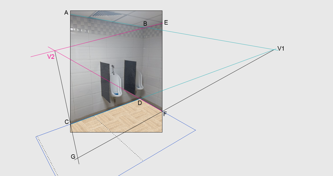

Dave,
regarding your post #2 with the very nice result by appearance –
could it be that the perspective is considerably wrong?
Let's follow this simple rule: all parallels in the scene have the same
vanishing point in the image.
Draw a line through A and B. Draw a line through C and D.
They'll meet in vanishing point V1.
Draw a line through E and B. Draw a line through F and D.
They'll meet in vanishing point V2.
Draw a line through V1 and F. Draw a line through V2 and C.
They'll meet in G.
The quadrilateral CDFG is a correct image of a rectangular part of the
scene floor, different to the suggested orientation.
Hope it's understandable. I'm normally not drawing by Photoshop but by PostScript.
Best regards --Gernot Hoffmann

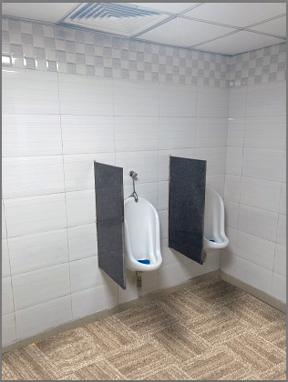

A wooden floor in a Men’s Rest Room. That certainly callls for perspective correction.
Jan 22, 2019 Jan 22, 2019
I was tempted to add a wet look but thought better of it
Dave

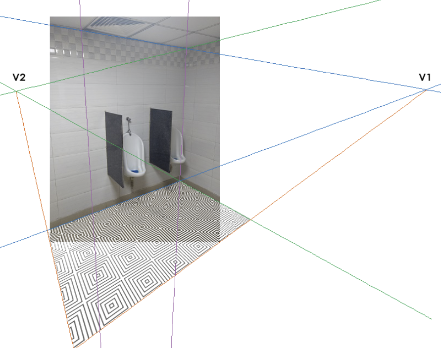

A slight variation on Gernot's post: Lines from the vanishing points through the corners of the image. A rectangular Pattern Fill layer was converted to a Smart Object, and transformed to fit the floor:
Note the converging purple lines. The image is actually tree-point perspective, and they meet at the third vanishing point (which is W A A A A A Y down there).

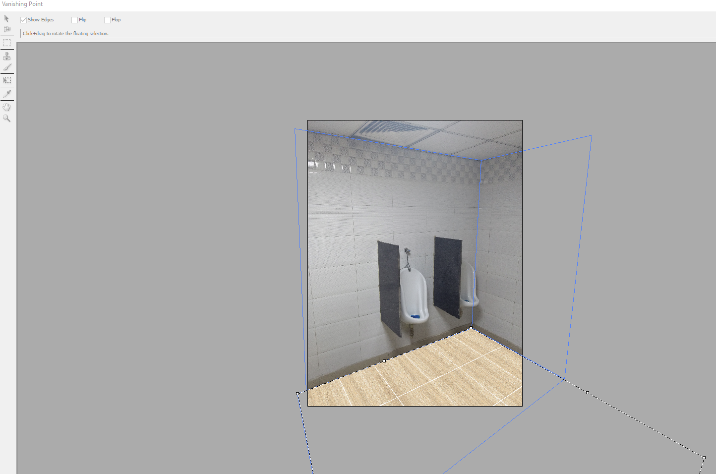

I guess since I am using PS CS2, these are the only options I get for Vanishing Point: I am not sure where I can set the grid size.
Anyway I used your method to create the plane from wall behind the urinals and stretched to the right and floor as seen.
First here's what I did for the tiles. I had two 300x300mm tiles (they had slightly different grains). I was required to copy these and place underneath each other so that one tile of 600x600 was created. I left a 2mm space on the edges and 4 mm in the joins for the grouting. I created a larger canvas to create a floor pattern with this.
I copied the floor pattern and dropped it in. This is what i get.
The tiles look stretched at this point.
What am I doing wrong here? I need to be able to see roughly 2x2 ft tiles laid out.

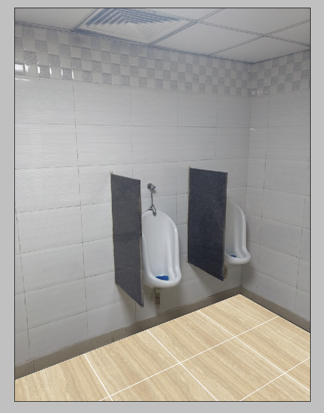

Ok i sort of played around got this output.
