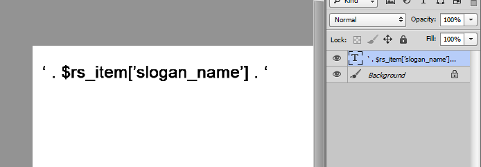

In Photoshop, your code gives this text in the layer
Show the real code that is executed in Photoshop. (jsx file)

Photoshop does not execute PHP scripts as far as I know.
How do you make a photoshop perform its native scripting code. That's what interests me.
Most likely there is an encoding error

People's Champ ,
Jul 15, 2018 Jul 15, 2018
I did not understand what you wrote above.
Well, I do not know.
You, like, wrote that with a short code you are all right.
Then try at the very beginning of your sample long code to paste something like
var dummy_utf8 = "Du ser mig kun for det tøj jeg har på";
Explorer ,
Jul 19, 2018 Jul 19, 2018
Hi can you confirm the correct code to add please for UTF8 BOM marker as  those // 1111 is what you sent?
People's Champ ,
I do not understand you at all. UTF8 BOM is three characters, a string of three bytes,
"\xEF\xBB\xBF"
or
String.fromCharCode (0xEF, 0xBB, 0xBF).
Try to google this question.
for example utf 8 - Encoding a string as UTF-8 with BOM in PHP - Stack Overflow
Explorer ,
Jul 20, 2018 Jul 20, 2018
Php is correctly formatting the text.
I have checked JSX files and its labelled correctly.
for example:
activeDocument.activeLayer.textItem.contents="""Tiocfiadh ár lá""";
So this JSX file has the above, which means PHP has correctly saved the correct text in the JSX file.
But when the JSX file is exceuted, it then shows
Tiocfiadh ár lá
in photoshop, so its something in photoshop charset causing it vs php.
Regarding the 111 code, you posted this back on
People's Champ ,
Put here a link to your "allegedly" correct jsx file. I'll see if it has UTF8 BOM
Explorer ,
Will send as PM.
People's Champ ,
web2000
Will send as PM.
You sent a copy-pasted text of the script where there are UTF-8 characters.
I do not need the text of the script. I need a specific jsx file, which is generated by your PHP script, and which you send the photoshop on for execution. I need a link to your file, not the text itself in this file.
