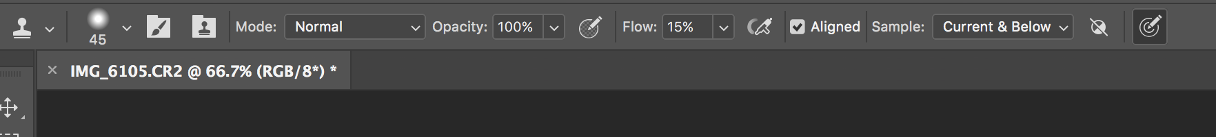

Suddenly when using the clone stamp it just doesn't work.
Is there something I can change to get it to work?
The screen shot shows where it is now.
Many thanks, Penni

hi
Have you tried resetting the Clone Tool

hi
September 19, 2018
Thanks Ged for guiding me through this.
