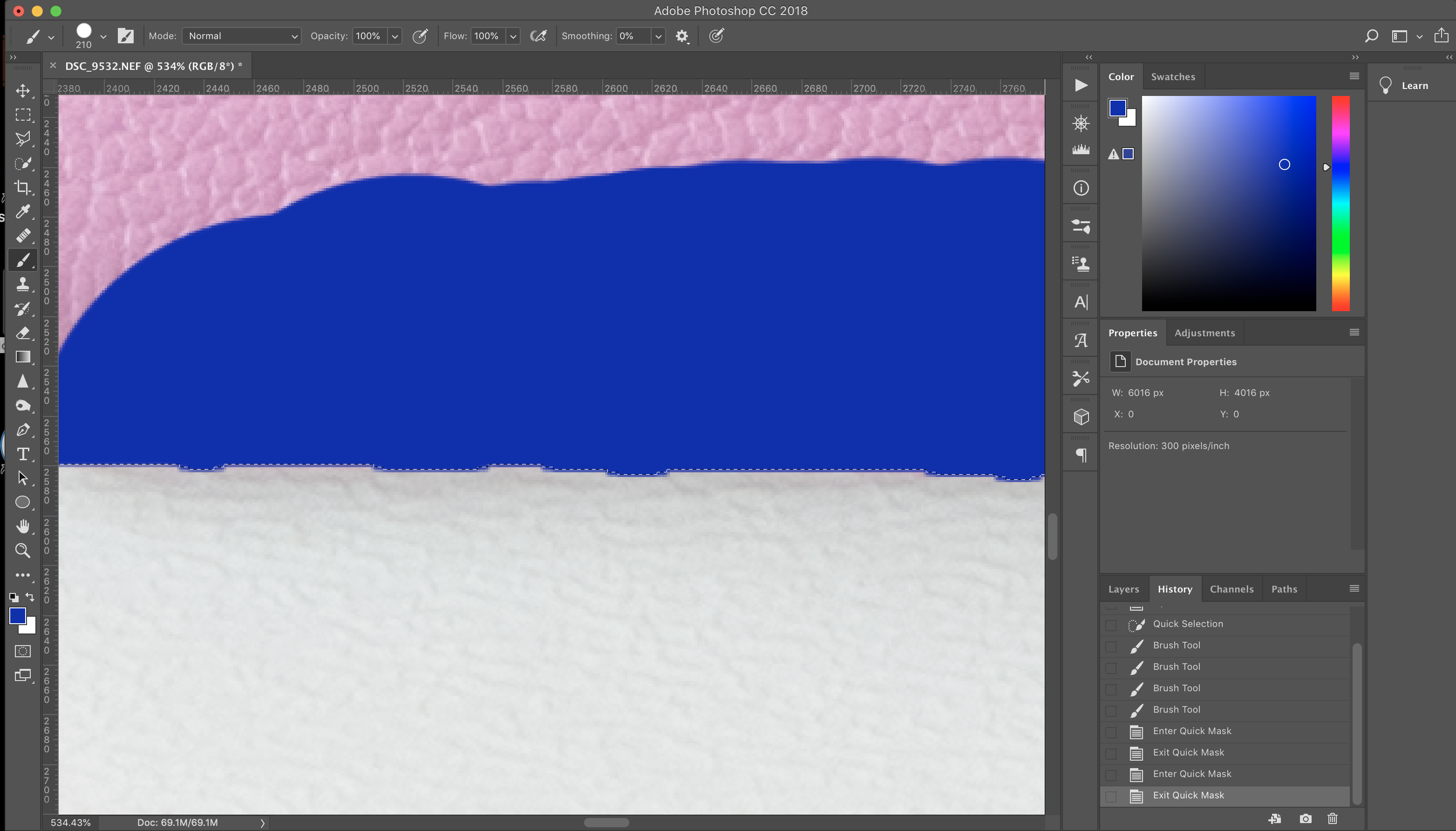

Hello
I tried to find an answer to this problem I have, but couldnt find it anywhere. I'm a beginner to photoshop. Can anyone help me with this? When I paint a color either inside or outside of a selection, theres always bleeding on the other side when I zoom in. Please see photo below. There's blue outside of my selection. Thank you!Screen Shot 2019-07-27 at 7.45.50 PM.png

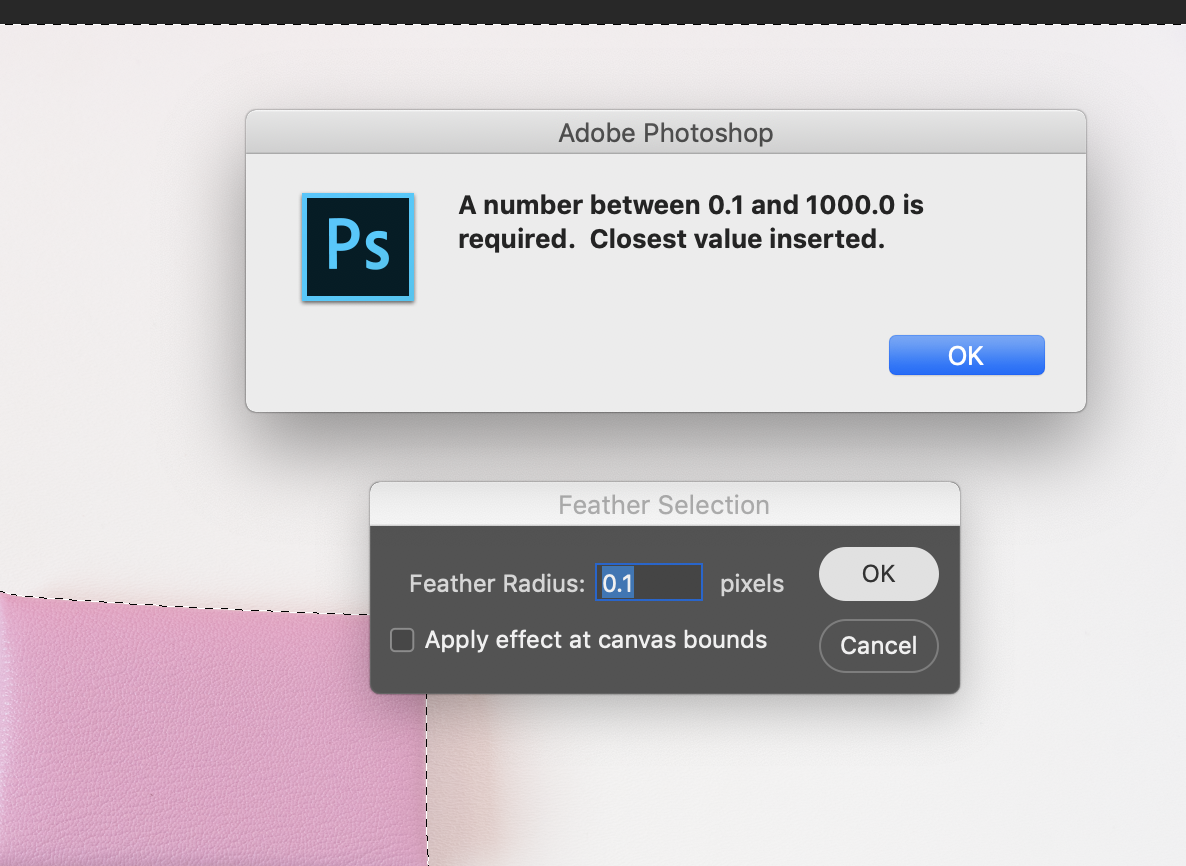

New Here ,
Jul 28, 2019 Jul 28, 2019
Thank you for your response! The feather has to be set at at least 0.1 pixels. But it didnt make a difference whether I set it at 2 or 0.1
It looks like you tried to change the feathering via Select > Modify > Feather. You need to set the feather to zero in the options, before y9u make the selection:
This is generally a "feather" issue as mentioned above,  Keep in mind that the selection/marching ants show without feathering and feathering extend both inside and out of the selected area.
As the others have explained, the selection/marching ants doesn’t show the feather of a selection. To see what the selection actually looks like, hit the Q key. That takes you into Quick Mask mode, showing the selection in an alpha state as a red overlay. This will show you the feather. Hit the Q key again to return to normal selection mode.
This is a screenshot with the quick mask mode. As far as i can see, the blue is still bleeding over than the intended selection.
This is heavily zoomed in image. I think you are complaining about anti-aliasing not fethering. Anti aliasing is actually good thing which is preventing fuzzy edges.
