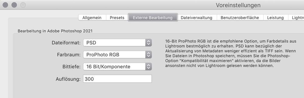

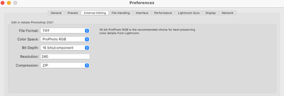

This can be due to the output settings in Lightroom. Can you upload a screenshot of it? More information would also be helpful. Most importantly, whether you changed anything before the problem occurred.
Community Beginner ,
Sep 14, 2021 Sep 14, 2021
No, I didn't change anything since I made the post. How do I view the Lightroom output settings? Do you mean the export settings?
I mean the External Editing preferences under "Preferences"
https://helpx.adobe.com/in/lightroom-classic/help/external-editing-preferences.html
I already included that screenshot
There you ago anyway

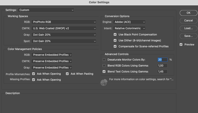

Same settings on photoshop btw

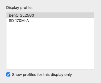

You are on a Mac and presumably not using a hardware device to calibrate your display but the one you are currently using could be corrupted. So the suggestion is to recreate or change that. See:
https://support.apple.com/guide/mac-help/change-your-displays-color-profile-mchlf3ddc60d/mac
Any difference?
Author “Color Management for Photographers" & "Photoshop CC Color Management/pluralsight"
Sep 15, 2021 Sep 15, 2021
Ok but I have no idea what color profile I should use, note that I'm using an external monitor (BENQ GL2580)
OK, several possibilities here. The BenQ profile could well be bad, in fact there's a pretty good chance it is. BenQ profiles are notoriously bad, along with some other manufacturers. You really need to get a calibrator. The monitor profile is a vital component and a calibrator is the only way to have full control over it. You can never trust manufacturer profiles.
Another possibility is that the profile itself is (more or less) good, but the wrong monitor profile is used by either Lr or PS. This is a rather elusive bug that has hit quite a few Mac users lately. The common factor and smoking gun is integrated display + external connected display. That's always the configuration where this happens. And that points to a bug in how displays are assigned in the video card/operating system.
What happens is that the monitor profile for the main display is used, even if the application is on the secondary display.
Precisely where the bug is I don't know. It has previously been reported from some Windows laptops, but recently it seems to be Macs. A workaround is to make sure the application is on the primary display as set in the OS.

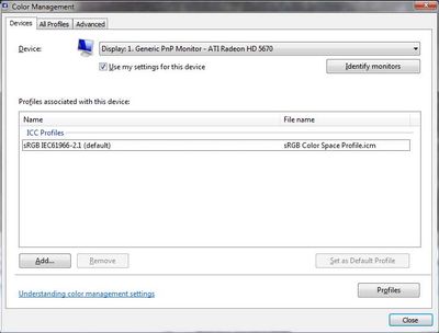

To find out if the monitor display profile is the issue, I recommend you to try setting the monitor profile for your own monitor display under “Device” in your Windows ‘color management’ control panel to sRGB temporarily.
(ALTERNATIVELY, if you have a wide gamut monitor display (check the spec online) it’s better to try Adobe RGB here instead as its better suits the display characteristics).
Quit and relaunch Photoshop after the control panel change, to ensure the new settings are applied.
You can click ADD to add sRGB if it’s not already listed there.
Once it’s selected, be sure to check “Use my settings for this device” up top.
And click on “set as Default Profile - bottom right
Screenshot of Color Management Control Panel
Depending on the characteristics of your monitor display and your requirements, using sRGB or Adobe RGB here may be good enough - but custom calibration is a superior approach.

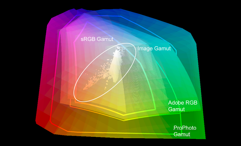

The artical you site contains some good information Jain, but unfortunatly misses some key information that any photographer must consider before saying "Bigger is Better"   The key information to consider is the gamut size of the actual image itself.   Placing a small gamut image into the largest possible RGB container space does not improve image quality.  In fact it can cause problems depending on the use case.   Here is an example of what I'm referring to:
Screen Shot 2021-09-14 at 2.11.41 PM.pngIn the example above I've placed the OP's image.  As you can see the image Gamut is smaller than sRGB.  So the benifit of ProPhoto is lost and all of the drawbacks still hold true.  Larger gamut container spaces are purpose built.  ProPhoto was built by 3 color scientists in the year 2000.  Not much newer than (Adobe 98 btw Andrew 🙂 )  Here's a link on the paper they published at the time.  The ROMM colorspace became ProPhoto a few years later.   So the one facter to remember here is not that Bigger is better, but what is efficient in the OP's workflow.
