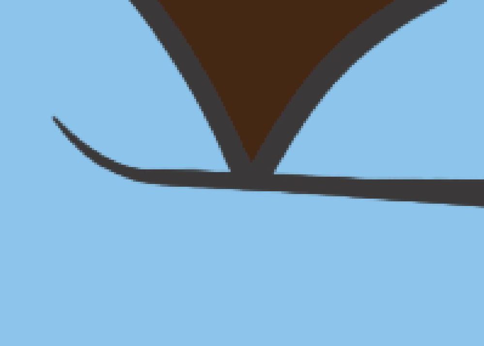

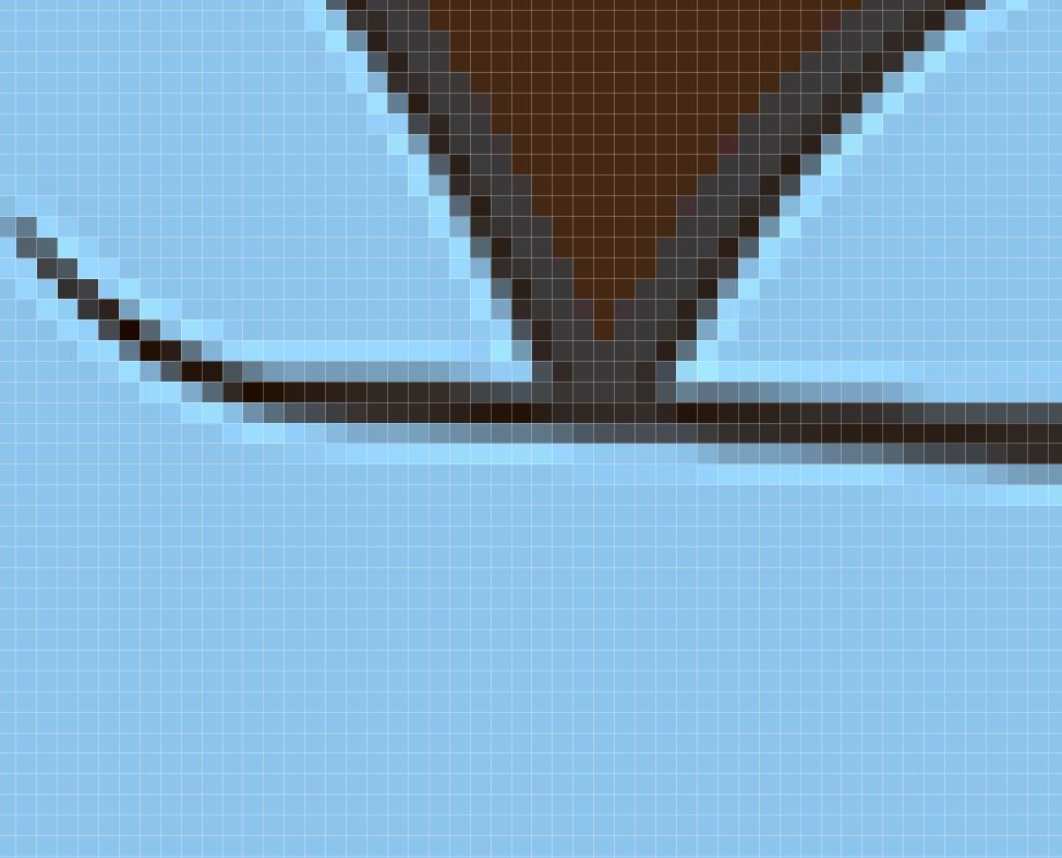

I'm currently working on a project and decided that it was too big but every time I try to resize the image there is some pixelation which is understandable but the issue is that it also affects the colors.
Before resizing
After
As you can see the greys turn to black and there's a lighter color surrounding.

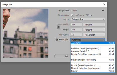

What type of Resample method are you using?

@JRStudios - use bicubic smoother or bilinear to avoid in-built sharpening halos. If the content isn't photorealistic you could also try the newer preserve details or preserve details 2 algorithms (generally for upsizing)... Or you can combine various methods.
Always keep a separate copy of the original, there's no getting those original pixels back.

In the Image Size dialog, you have several different options for the resampling:
Some of these methods apply sharpening, which it looks like your issue is here. Try some of the various methods, and see if one of them gives more desirable results.
May 01, 2024 May 01, 2024
That's right. I always use Bicubic Smoother, because it has no built-in sharpening (or very little). Then I apply my own sharpening afterwards, usually with the ACR filter which is great for controlling halos and artifacts.
The one to avoid at all costs is Bicubic Automatic. It oversharpens terribly.

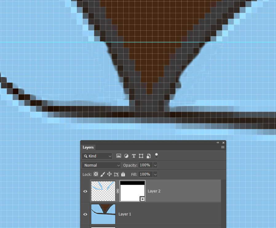

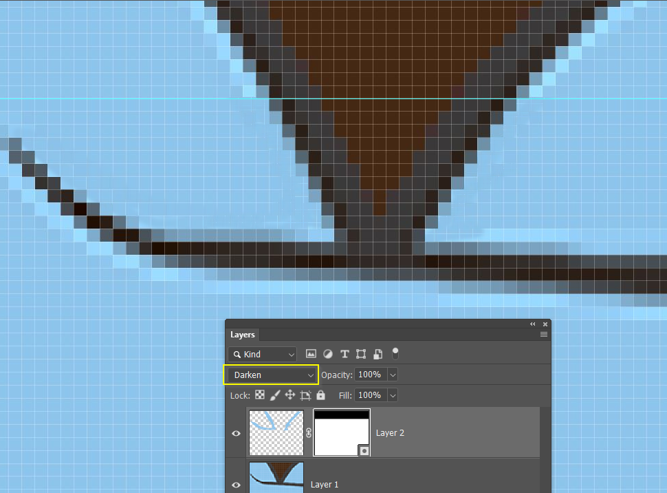

There's a trick you can use to remove halos — although obviously better to avoid them in the first place.
Anyway, make a new layer, and se it to Darken, and use the clone tool.
I've used a mask above the guide to show before and after.
You can see that the clone tool has covered the black pixels
But if I set the layer to Darken, they only show over the lighter halo tones.  It's a good tip for removing CAs
The cloning is done on a new layer set to Darken, and is entirely non-destructive.  None of the darker tones are compromised.
