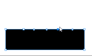

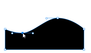

Rather than drawing the wave from scratch you could do this --
From the Shape tools, select the Rectangle tool.
Make sure that Shape is selected in the Options bar.
Drag over an area to create a rectangle.
image.png\
Select the Pen tool.
Click the top edge of the rectangle in two different place. That will add two anchor points.
Select the Direct Selection tool.
Press on a point and drag it into position.
image.png\
