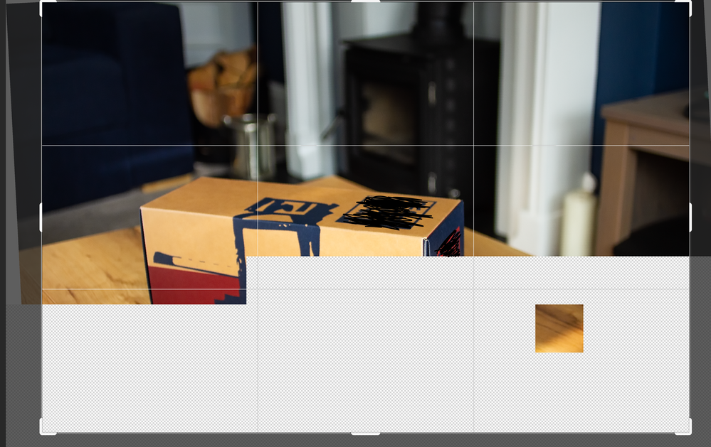

I've noticed that when cropping or rotating in PS 2020 the app goes haywire and often shows a little countdown timer like it's waiting to do something, then when it does wake up I get half the image missing and it's replaced with a chequerboard pattern. I often can't even use the tool because I can't see what I want to straighten up. I wouldn't mind but I've got an iMac Pro maxed out in all areas so I shouldn't be seeing screen draw issues. Any ideas?

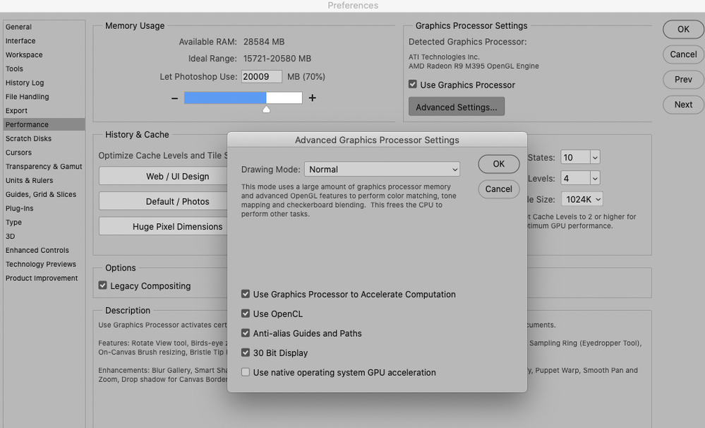

Does turning off »Use Graphics Processor« in the Performance Preferences (Photoshop > Preferences > Performance > Graphic Processor Settings) and restarting Photoshop have any bearing on the issue?

What do the checkerboards look like exactly?

Also when I crop, that little box follows the cursor around the screen.

Yes this has fixed it on all the machines, thanks so much, been driving us all mad.

Unfortunately this is no proper solution as it invalidates GPU dependent features (like the Rotate View Tool, 3D and some Filter acceleration for example) but it indicates problems with the GPU driver or the OS.

You could try to change the Advanced Settings to see if that makes a difference (but remember to restart Photoshop for the settings to take effect).
