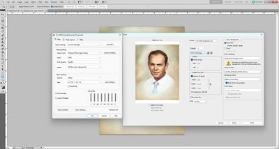

I need a refresher course. I am printing photographs from CS5 to an Epson Surecolor P400 on Ilford Galerie paper and my prints are dark. I know CS5 is old, but I bought it years ago and that's what I have.
I just don't understand whether to use the embedded working space, to let Photoshop or the printer handle color, or to choose the printer profile or the paper's profile .icc
I know these are basic questions but I have never had a clear understanding of which way to go and every tutorial seems to say conflicting things.
Are there simple answers somewhere or good tutorials I can use? My monitors are set up well and my colors are good, but dark. I can get an excellent print, but I waste paper in the process.
Help?

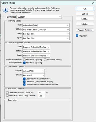

If you get a dialog about the embedded profile not matching the working space when opening an image, choose the embedded profile. The profile doesn't have to be the same as the working space, which is a fallback if the image is untagged (does not have an embedded profile).
To stop this dialog from appearing, go to Edit > Color settings, and set Color management policies up like in the screenshot below, which is from CS6.
Make sure that Ask when opening is unchecked for Profile mismatches.
The recommended procedure for printing is to let Photoshop manage colors, which requires color management in the printer driver to be turned off. Everything seems to be set up correctly in your screenshot, but it seems that you have converted the image to Epson sRGB. There is no need to do this, just leave the image in whatever color space it had initially. Also make sure that you're using the recommended (by Ilford) paper setting in the printer driver, and that
you are using the correct printing profile for the paper/printer combination you're using.
If printed colors are correct, but the print is too dark, your monitor is most likely too bright.
Adjust the brightness to match the print.

Thanks for your reply. My color profile for this particular image was Epson sRGB because it was from a scan from an Epson V600 scanner. I did not correct the mismatch. I remain unsure about adjusting my monitor settings as even holding the original up to the monitor looks nearly identical, and using auto color and level adjustments on the image in Photoshop on this scanned image still renders dark prints.
I see that our color settings are only slightly different. Does this suggest anything to you?
May 01, 2025 May 01, 2025
Your color settings are fine.
