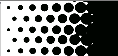

Set the blurred layer to Hard Mix:
This technique is often used for making halftones.

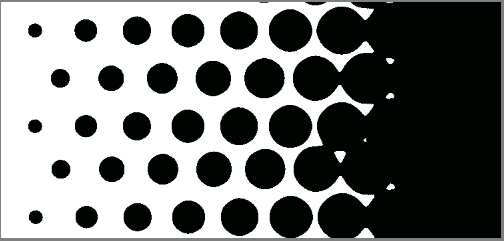

Hi
If you use Hard Mix you will need to reverse the gradient to that shown in your description
With hard mix the channels are added and if the result is greater than 255 then it is set to 255 if it is less then it is set to 0.
So at the white end of the gradient (right in this case) it turns white. You wanted it to turn black.
Eaxmple
Gradient :
Blurred grid :
Using Hard Mix  - the result does not match your requirent to have the black at the right of the document where the gradient is white:
Using Divide and Threshold and Invert (as per my previous post): - Meets the requirement:
Inverting the gradient then using hard mix - also meets the requirement:
