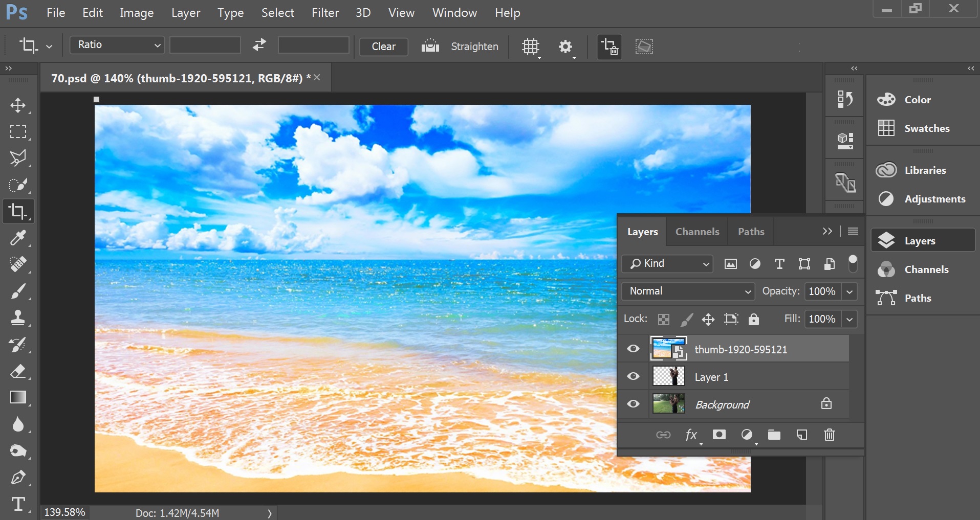

The first picture is where i put the beach down and then placed us on it. The second picture is where all attempts to mesh the two pictures occured i just dont understand what im doing wrong. I mean i imagine i could use the earser and ger out the whiite or the pen but id like to be able to do it the correct way.
Community Beginner ,
Apr 09, 2018 Apr 09, 2018
P.s I aslo made sure to get on the second picture on the thumbnail of the beach im not sure why in the lower right hand corner you see like that little folder icon. I watched 20 tutorials last night and no one else had that on there thumbnail. And it never pops up until i drop the beach photo and then i hit place.

Hi
The symbol on the beach layer thumbnail is indicating that the beach image has been placed in a smart object. That just acts as a container and can double click on it to open the container and edit the contents. That is not the problem here.
Your issue is the layer order. In Photoshop images are viewed looking from the top layer downwards. So the beach layer is covering up the people layer. Just drag the people layer (labelled layer 1) to the top in the layers panel.
It looks like you need to follow some tutorials on masking to get the edges to blend. In Photoshop we tend to make a selection then turn the selection into a mask. The advantage is that the mask can be refined and altered later - which is not the case with a copied/cut out section.

Im not sure what you mean at the moment the people is labled #70 at the top if i try an drop it on layer 0 it does nothing so im not sure exactly looking at the box what you mean by the :"top of the panel " thank you. Umm and ive watched about 20 tutorials on masking to get the edges to blend and i follow step by step exactly to the letter what they do in the videos and i always get the error message.

You are getting the error message because you are trying to refine a selection and you have not made any selection.
You only need two layers.
The beach layer and the people layer - make the selection round the person and if in Select and Mask choose Output to Layer Mask. If you made your selection outside of Select and Mask then go to Layer >Layer Mask >Reveal Selection
The layer mask is the black and white thumbnail next to the image thumbnail. Where it is black the layer is hidden, where it is white the layer shows. You can click on the mask thumbnail and paint directly with a black/white brush to change it.
