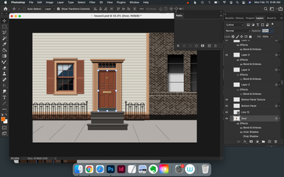

For some reason the Deselect menu option (and shortcut) are both unavailable. I'm trying to move, transform and deselect various objects. Thanks!

Perhaps Selection is the wrong term, I want to select various layers by clicking on them and then move them... then deselect when I'm done so that I can see my painting without the blue Transform controls. How do I deselect a layer when I'm done? I used to be able to hit Cmd-D (on Mac).
I have "Show Transform Controls" checked, otherwise I don't see what I've selected. I don't want to toggle this setting every time I want to glance at my drawing without transform controls showing since I want to switch often between moving items and seeing my screen without anything selected.

As others have said, you do not have an active selection (marching ants). It appears that you may have a Path selected. Open the Paths panel from the Window menu and click in a blank area to deselect. You can also use the Path Selection tool ("A") , the black arrow.
Show your Paths and Layers panels if you need more help.
EDIT: I don't see the Path Selection tool in your toolbar. Go to Edit > Toolbars and either Restore the toolbar OR drag the Path Selection and Direct Selection tools to your toolbar if you plan to work with Paths.

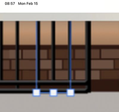

I also want to be able to deselect so that I can select another item close by, otherwise I can't click a nearby object and my cursor looks like this:

Again, you cannot deselect because you do not have a selection. What you are seeing is the Rotate widget because you have the Transform Controls showing.
  • Turn off Auto Select so that you continue working on the layer you selected on purpose.
  • Select the pixels if you want to Deselect them.
  • If you are not doing Transformations, then consider turning off the Transform Controls.

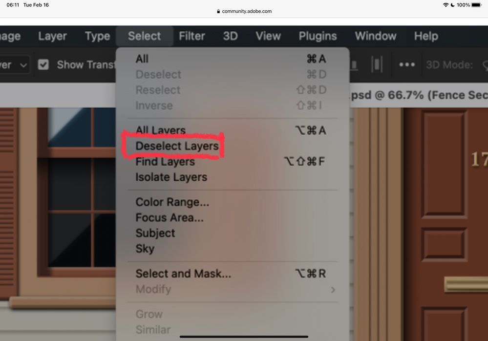

You are correct that layers can be selected in addition to pixels on a layer. In the Select menu, "Deselect" (Cmd+D) means pixels. To deselect all layers, choose "Deselect Layers" from the Select menu.
https://helpx.adobe.com/photoshop/using/selecting-grouping-linking-layers.html

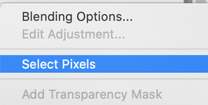

Showing Transform Controls is not the same as making a selection. To select the pixels and see the marching ants, one of several ways is to right-click the Layer > Select Pixels. Then you can choose Deselect.

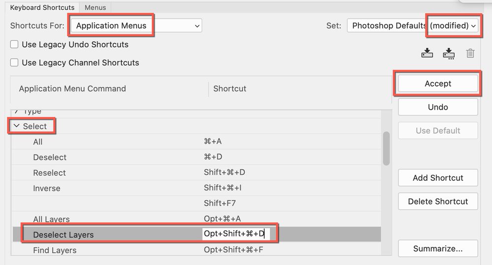

Thank you, deselect layer is what I was looking for.  Is there a way to make a keyboard shortcut for this command on a Mac? Attempting to do so through my Mac's system preferences failed, with a message that Photoshop is not eligible for custom shortcuts.

Edit > Keyboard Shortcuts > Application menus > Select (menu) > Deselect Layers (command) > add a shortcut > Accept

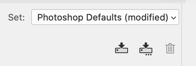

Click the Save button to save this as a new set:
