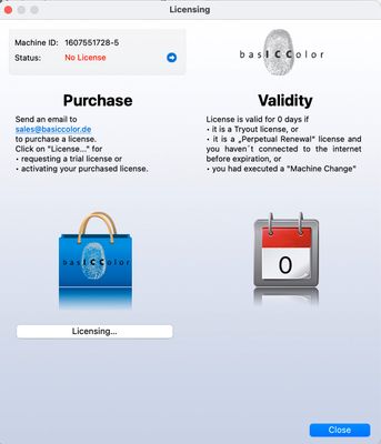

HI @lilCystar basICColor display after installation offers a trial licence. 14 days, it supports any display, it's just measuring screen output and building a characterisation (ICC profile) - same way the Spyder does but in a longer, more thorough, process.
When you start the basICColor display software, you'll see this licensing screen,
if you don't see it, look under the help menu/license
see above, under Purchase it says "click on 'licence' for requesting a trial licence. "

Participant ,
Aug 03, 2024 Aug 03, 2024
Hi there.
I installed basICColor display and clicked on 'license' and got the page attached below as a screenshot. It says to click 'test license' for a free trial but I do not see those words on the page.... also don't know what the warning in red means. I created and was signed into, a baslCColor account while I did this.

Aug 05, 2024 Aug 05, 2024
@lilCystar  the red warning text 'you are not connected to the license server' is the issue, it suggests either you're not online or you're not logged in.
The Adobe RGB test page looks good on my monitor. Thanks for that
My testimage? I'm pleased you found it useful, the "memory colours are helpful, I hope"
Will try the new basICColor display software if I can activate the free trial.
I'm afraid you'll need to get logged in and connected to the license server to get the demo licence.
