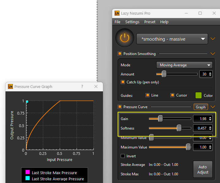

Interesting that you are using LNP.  Try turning it off and see if that makes a difference?
If it works OK with LNP turned off, then you obviously need to look at your settings, but if it doesn't make a difference, you might be able to cheat the driver into working.
The pressure curve settings below would give 100% opacity with 50% pen pressure if everything was working normally.  If this fixes it, then the problem is that you are sacrificing half of the tablet's pen pressure range, so not ideal.
So try these tests and let us know what happens.  Ideally, you have your LNP settings wrong and can fix them.  Try the settings below.  That should give you full range of sensitivity.

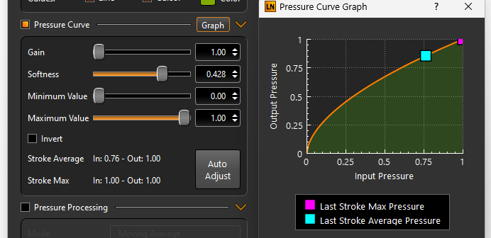

Make sure max value is at 100%, although I don't think that is the issure because you said you can get dark strokes by pressing really hard.  With max value at 50%, no amount of pressure would produce more than 50% opacity (or stroke thickness if that's the brush setting you are using)
Putting Softness to a high value should increase opacity more quickly against pen pressure.
If all this makes no difference, then we'll look at your Huion driver.
