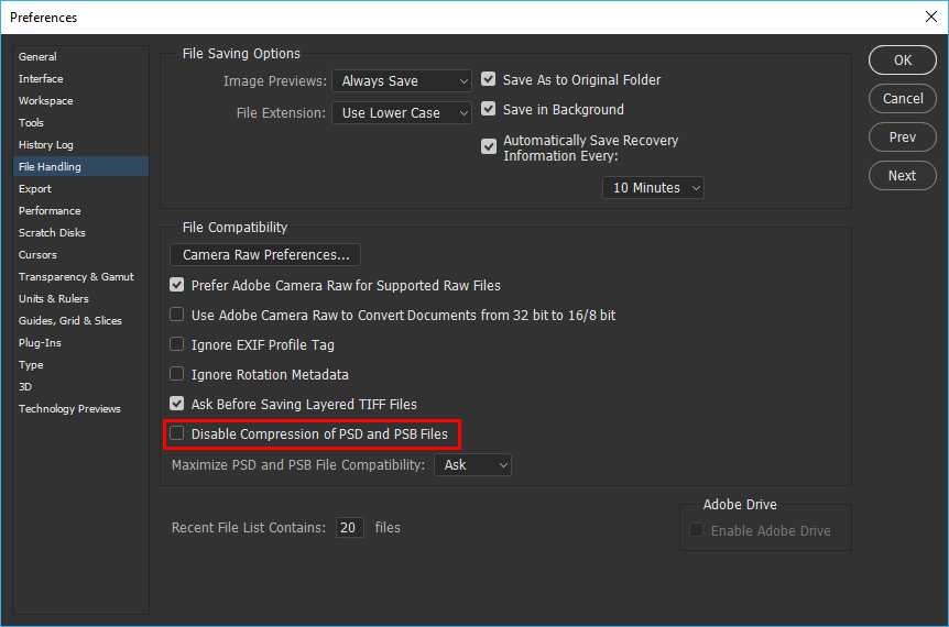

I was experimenting with compression of psd and psb files but it seems not to work (Photoshop CC2017.1.1).
My aim is to monitor performances while opening/saving a 2.9GB psb on SSD and HDD.
Unfortunately disabling compression seems not to work, indeed the file saved without compression is the exact same size of the one saved with compression (already tried not maximizing compatibility).
So far my findings with compression on are as expected, the two drives have nearly the same timing:
Compression enabled1xSSD1xHDD2xSSD2xHDD3xSSD3xHDD
open (s)10.211.810.610.410.210.4
save (s)14.117.313.814.313.814.2
is there a way to effectively disable the compression?
I tried checking disable and reopen Photoshop but still not working.

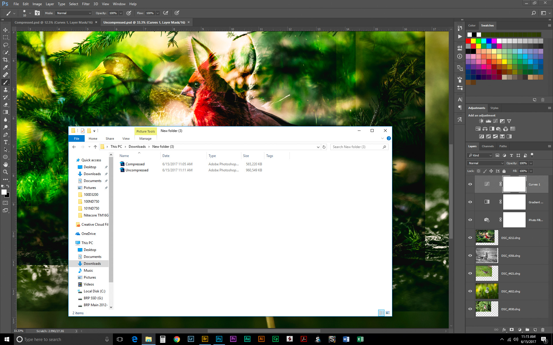

Just got back to my workstation and gave compressed/uncompressed PSD a try. The compressed PSD took longer to save, so I figured it had worked.  Sure enough, it had - compressed: 565,220K; uncompressed: 960,549K. See here:
So now I must ask for further details on your testing process. Did you simply change the setting under Edit > Preferences > File Handling and save...or did you change settings, restart PS, rebuild file, save? The latter is what you should do.

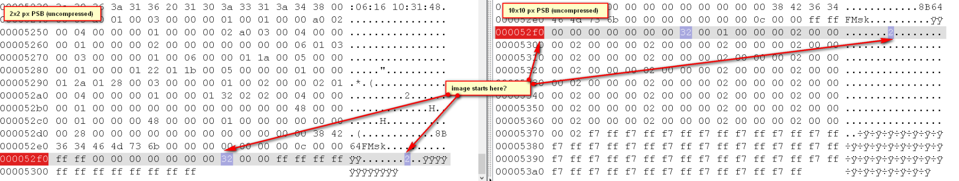

Community Beginner ,
Jun 16, 2017 Jun 16, 2017
Really interesting!
I'm pretty new to this stuff, I think I got the image data section start address but how can I understand if it is compressed or not?
In the example below there are 2 "uncompressed" PSB (in the sense that disable compression was checked):
- the left one is a 2x2 px 1 layer (background layer only) all white;
- the right one is a 10x10 px 1 layer (background layer only) all white.
You can see the compression in two ways.
The image data section immediately follows the byte with value 32 that you highlighted, and easy to work out on the 2x2 file.
The first two bytes are 00 00 which , according to the spec. I linked previously, indicates Raw data i.e. no compression. This is confirmed in the following data which is 3 blocks of 4 bytes all set to FF. That corresponds to 4 pixels with R G and B all set to FF.
If you then take a look at the second file you can see that those first bytes are now set to 00 01 which, according to the spec,  indicates RLE compression. The image data format is now very different and does not follow a straightforward R G and B value for every pixel. The section is also shorter than uncompressed which would take 300 bytes if in Raw format.
Dave
