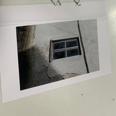

I edit all my photos in Adobe Lightroom Classic and export them - in .tiff and .jpg (just want to give you the biggest amount of information possible). When I send the images to a graphic shop and they print them, the majority of the images come out with a lot more saturation (more yellows mainly) and a lot more vivid/have more texture to them. I don't have the best examples with me, but below I'm going to leave you with some examples.
I'm placing them side to side. The print of the left has a lot of texture and is darker. The one on the right is the computer image.

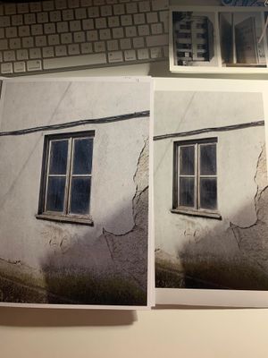

Today I printed the same image. On the left, at the print shop, and on the right, an older copy I printed in university.
I know different printers will give me different results, clearly, but my question is: might this be a printer problem ONLY or could the problem be the picture profile I'm using?

Most consumer-oriented print shops don't have a properly color managed process. They basically assume sRGB, but even for sRGB files, don't expect a high degree of color accuracy. Some of them may even have auto-correction applied to every image. In short, all bets are off.
If you send files in a larger color space, P3/Adobe RGB/ProPhoto, to a print process based on sRGB, you get a loss in saturation. You can mimic the effect by assigning sRGB in Photoshop. And in fact, that is what your example shows here, in print shop left vs. older print right. Although it's hard to judge which one is actually more saturated, as this is more or less a monochrome image.
I think you'd need to use another image with more color to make any judgements here. A blue sky usually gives a good immediate indication.
Or just ask them. If they can't answer, probably go somewhere else.
