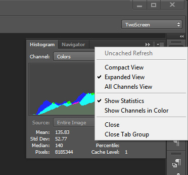

Does anyone know of a script clear the histogram cache and copy its data to the clipboard?
Community Beginner ,
Jan 20, 2015 Jan 20, 2015
I find myself manually copying pixel counts from my histogram into excel and am wondering if there is an existing script that allows the user to copy the histogram data onto the clipboard.
From a QA standpoint alone this would be a huge advantage!

I'm on Windows 8.
I've played around with the histogram.jsx that was included in Photoshop CS4(?).
It receives its total pixel count from imageH * imageW so it only works on rectangular selections.
My specific application involves creating a new layer from an irregular shape selected in an image and then measuring the total pixels present in that shape which are then copied into an excel spreadsheet.  We have a constant that we multiply our pixel count by in order to determine the area in centimeters of our irregular selection.  For example if our layer contains 1109078px and we know that our images scales at 255.53 pixels/cm then we can calculate our selected area to be 21.84 sq cm.
Because we make measurements twice on each of the hundreds of images spanning dozens of sites I end up copying the pixel count from the histogram by hand an huge number of times.  Hand copying means the possibility for transcription error which has the potential to alter our data.  Just to give you a baseline, I've made 733 transcriptions of that readout on the current site I'm analyzing.
Getting at the histogram and copying directly to the clipboard would be the most efficient and sound way to copy the data.

Does this work for you – you only want the total number of the pixels in the Selection in the Clipboard, right?
// 2015, use it at your own risk;
#target "photoshop-70.032"
if (app.documents.length > 0) {
  var myDocument = app.activeDocument;
  var theName = myDocument.name;
  try {var theName = theName.match(/(.*)\.[^\.]+$/)[1]} catch (e) {};
  try {var thePath = myDocument.path}
  catch (e) {var thePath = "~/Desktop"};
  if (myDocument.mode == DocumentMode.MULTICHANNEL || myDocument.mode == DocumentMode.GRAYSCALE) {
  var theHistogram = myDocument.channels[0].histogram
  else {var theHistogram = myDocument.histogram};
// get total number of histogram:
  var theNumber = 0;
  for (var m = 0; m < theHistogram.length; m++) {theNumber = theNumber + theHistogram};
  copyTextToClipboard (theNumber);

Well that certainly did the trick!  I was going about it a little differently and only able to copy a rectangular boundary around my layer.  This works perfectly.
