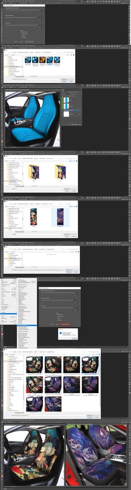

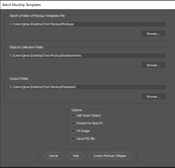

Duplicating smart Object layer to share object is very useful for making Templates easy to use populate and and warp object several way for example car seat covers. It is a great feature.
IMO if you are creating templates they should be easy to use  and easy to maintain.  You should not create template that are complex to use and hard to maintain for you put too much into a single template PSD.
It would be simpler to have multiple simple templates then a hard to use complex to populate and difficult to maintain templates for you have put too much in one basket.   I  think you may have, many products, and many design elements and many logos and you have incorporated all into a single PSD Template.
I'm a simpleton fat and stupid. I have but one rule.  Keep it simple stupid yes  you(me) stupid.
I would have a template for each product that I would populate with  design and I  may duplicate a template for each product that incorporates a different logo  that will be added to each populated design.
Very simple easy to create and populate mockup templates.   Very simple basic mockup templates that can be batch populated with Photoshop Automation.   Not complex templates that need to be populated manually tedious and hard to do for much customization need to be dome  populating these complex mockup template.  I'll drink a bottle of wine while my batch mockup populating script  populates my collection  of simple mockup templates with my products designs and saves out populated jpeg images.
Now where did I put my cork screwy thingamajig?
JJMack

Copied
JJMack

Copied
JJMack
