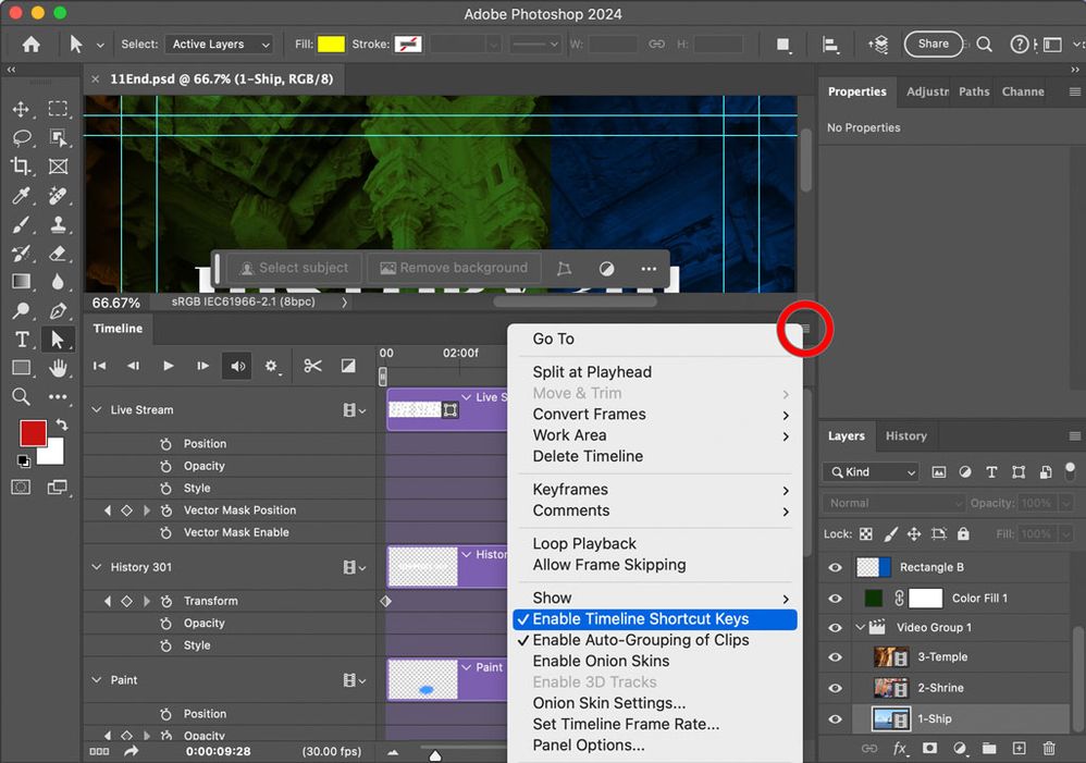

February 19, 2024
I got it to work by creating the command 'Ctrl+cmd+1' in Workspace/Keyboard Shortcuts and Menus/Timeline Video.  A bit of a hassle when virtually all other apps use right or left arrow keys.

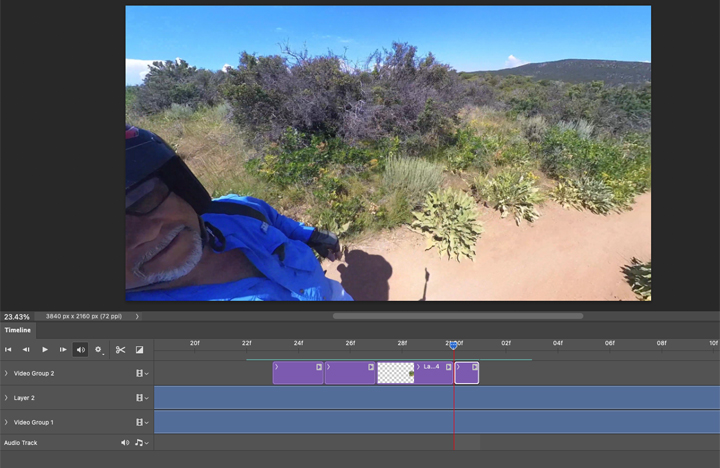

Okay, so I got the copy-paste idea to actually work.  The key is, as you said, creating a layer to do the work on.  I used that layer to use the remove tool to take out some lens flare earlier in the video.
I copied the area I wanted to paste from the original timeline, but it created another layer above that one, for some reason(?).  Once pasted, you can transform the copied area to "fit" in the new frame.
A couple of weirdnesses though - each attempt at this creates a new layer.  I am figuring out that I can transform the correction layer as needed, then cut the layer down to one frame after it's created (see 'layer 5' in the image - this is one frame - the other three layers represents two frames).  The copied area will remain as it was pasted and transformed for all following frames, and while it looks okay for small changes in perspective, I think I will have to redo this process correcting one frame at a time, two at the most for the best results.
I was able to trim and pull the layers down to one line (Video Group 2) but any attempts at merging them together and keeping them in sequence causes some of the "layers" to disappear.  I don't get this - highlighting them then trying to merge layers, merge visible, etc. causes problems.  My thinking is that it will "overwhelm" my computer to have layer after layer with one corrected frame each.  That's why I wanted to try to join the completed correction layers together in a continuous stream, to keep the cache from getting filled up.
But, all in all I am making progress on this idea.  Any pointers you can give on joining the layers and maintaining their sequence horizontally?
