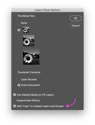

For me, the issue was that i had Unchecked the "Add "copy" to Copied Layers and Groups" checkbox under Layers Panel Options, so my actions that were looking for "Background copy" layer, were only finding "Background". Once i rechecked the box, all worked as planned.

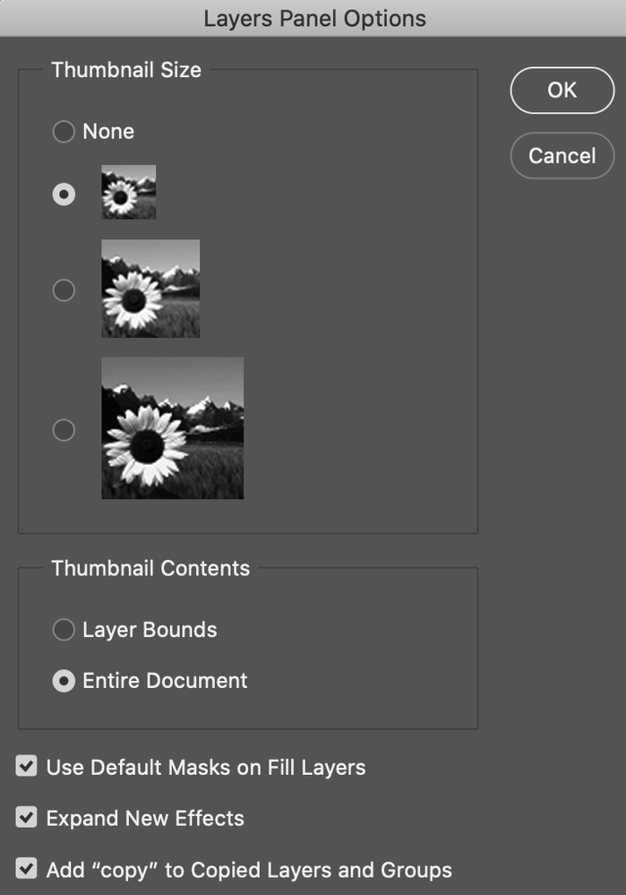

Make sure also that you didn't uncheck the box "add "copy" to Copied Layers and Groups" cuz if you did, most actions are programmed to select the copied layer by it's name "layer 1 copy" 😉 this option is in the layers panel optionsCapture d’écran 2020-04-29 à 11.22.38.png
