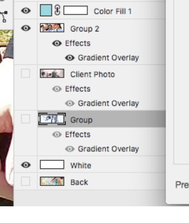

See attached screenshots. Shut down PS, restarted and this. Not sure what I'm missing. Original art up top; export options below; layers palette to the left. Missing bottom white grad.

You have a layer mask that creating the effect. Use PNG and make sure it is transparent Background!
PNG will maintain transparencies. Also you have Quality 30% so it might take out some effects. Try Quality 100%

Turn off the white background...see if it works.. if you export to JPEG with a white background it will take away the gradient..

Looking again at your screenshot your gradient overlay layer is not on. Turn it on I am sure it will be back!
(visibility....) and the white background is on.
