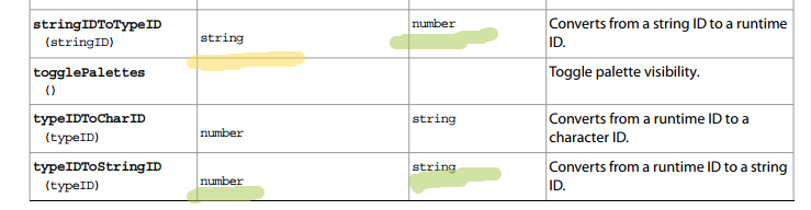

Adobe Photoshop CC JavaScript Reference - a book that should be at hand.
If we look at how we can put some value in the ActionDescriptor, we can see that all three arguments must be represented by numeric values
Your code has an example of writing to ActionReference EnumerationValue (yes, it's a different object, but the function is similar):
r.putEnumerated(stringIDToTypeID(p), stringIDToTypeID("ordinal"), stringIDToTypeID("targetEnum"));
What's going on here? Each string variable is con
What's going on here? Each string variable is converted to a numeric type using the stringIDToTypeID function.What do we need to do when reading when we get a numeric type as a result of executing getEnumerationType or getEnumerationType?
That's right - execute the function that is the reverse of stringIDToTypeID, that is, typeIDToStringID:
