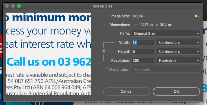

I have a Photoshop file set-up as per the attached image. 180mm x 50mm, resolution of 200ppi.
I want to export it as a GIF with a transparent background and at the size and resolution as the file set-up.
When I do export the file, either 'save as', 'export' or 'save for web (legacy) it saves the file at 499mm x 140mm and a resolution of 72ppi, see image attached.

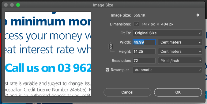

The animation below was created from the file that was attached: The Image Size dialog box from the original vs the GIF export. The image size, in pixel dimensions, did not change.  Other than the expected file size change, the only other change was the assumed physical dimensions (cm), which had to happen because the ppi changed when the actual number of pixels did not.
Why did the ppi change? It isn’t just that ppi etc. have no meaning on the web, I don’t think the GIF format has a way to store inches, mm, or ppi. The only way to express dimensions in the GIF format is pixels, as far as I know. Trying to shoehorn any other unit of measure into GIF will require conversion to pixels. When Photoshop opens a GIF, it assumes 72 ppi because there is no ppi info in the file.
If you want to save as GIF, you must accept that the ppi value will be discarded.
If you want ppi to be respected, Save As to a format that can store a ppi value, such as JPEG.
Why Save As instead of Export As or Save for Web, for a JPEG? Save As preserves maximum metadata, while the latter two do optimization for the web, so they discard any metadata not required for web browsers, including ppi, to keep file size as low as possible.
Also, nothing has changed recently in this area, everything above has worked that way in Photoshop for many years.
