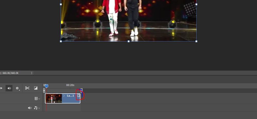

Community Expert , Oct 16, 2019 Oct 16, 2019
click on play button where i made the circle then you get it...Regards

Oct 15, 2019 Oct 15, 2019
Check the Images hope your probelm will be solved...Regards

New Here ,
Hi! How do I get the menu to pop up?

Hi
A gif has no fixed frame rate. If you want it to run at an approximate* speed then set a frame delay to match your required frame rate. Delay = 1/frame rate   Do not set it to zero as that will force playback as fast as the browser/play can play it.
*I say approximate because the actual playback speed will still be browser /player dependent. Set delay too short and the browser may limit it any way
