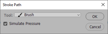

If you have a pressue stylus, then it's easy by turning on Shape Dynamics in Brush Settings and under Size Jitter enable Pen Pressure, then you can vary how thick the brush stroke is by how hard you press the stylus on the tablet.
Just using a mouse you would need to draw out a Path then stroke the path with pen pressure checked.
You have much more control using a Stylus.
Mar 16, 2025 Mar 16, 2025
" Just using a mouse you would need to draw out a Path then stroke the path with pen pressure checked."
Like this:
While the stylus offers more control, stroking a Path is good for long smooth strokes

Thank you for your help! It seems to do the trick.
I was confused after a long night looking at tutorials and searching for help. And the example brush in the box didn't show tapered end after configuration. I tried as you showed and the stroked path now have tapered ends 😄
