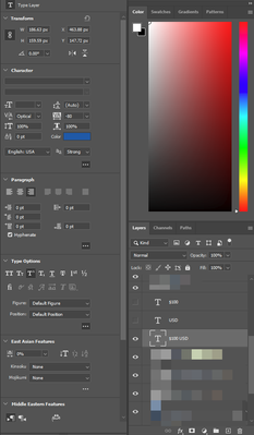

Sorry! I forgot to mention that I need the text to be centered on that white background, too.
It can be easily done if I didn't need the price to be centered inside of that shape, but unfortunately I do. Any workaround or should I just give up?
Here's my panel:
Nov 16, 2022 Nov 16, 2022

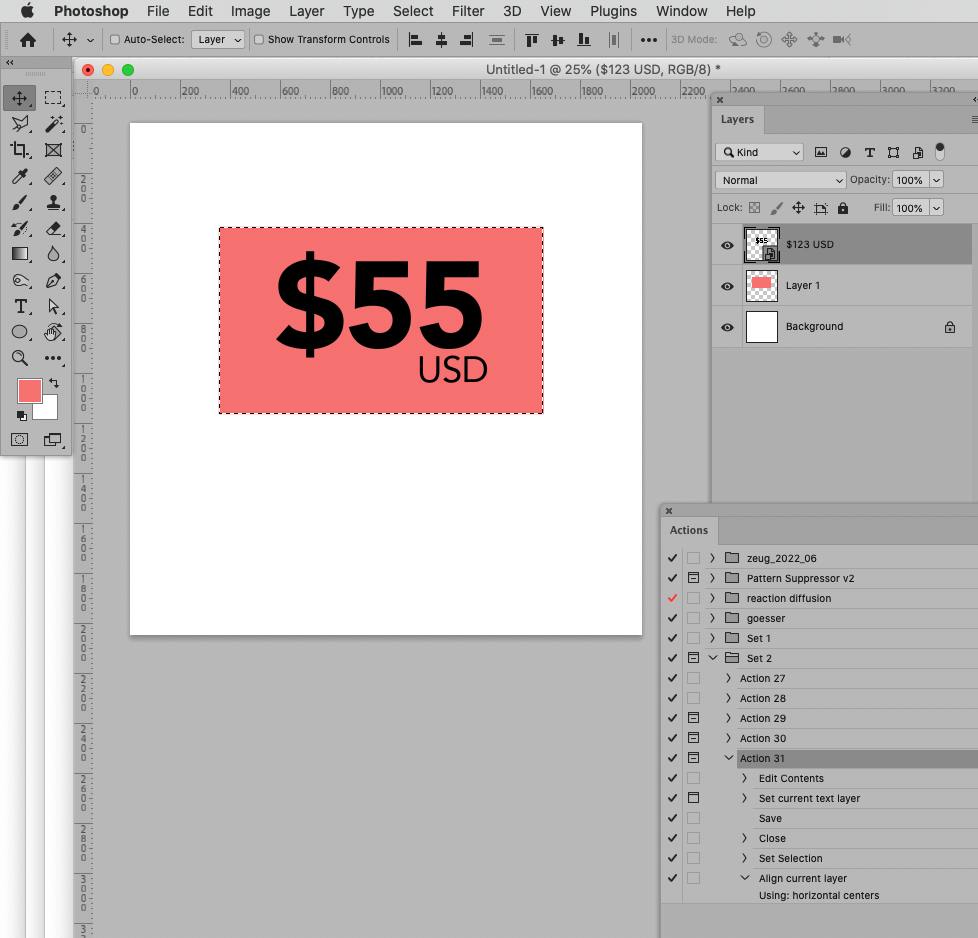

You can use an Action to automate the task.
Screenshot 2022-11-16 at 12.04.54.pngScreenshot 2022-11-16 at 12.05.59.pngScreenshot 2022-11-16 at 12.06.27.png

Actions provide automation with the option of some input.
One can record a procedure (some steps may not be recordable in a meaningful manner, though) and then play it on other files etc.
In this case »Set current text layer« has the »Toggle dialog on/off« button checked, so I can enter new text before the Action resumes.

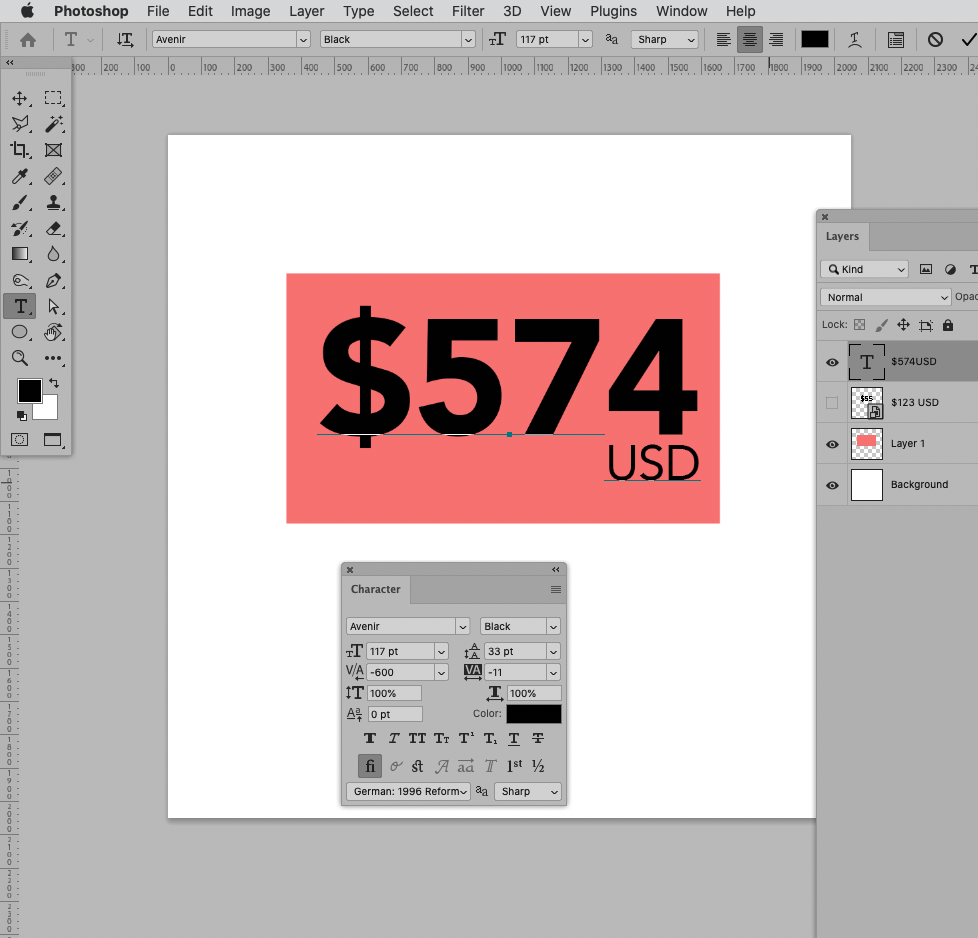

Another option might be using Baseline Shift and Kerning.
But one may have to re-apply the kerning if one has to change the the rightmost number, too.
