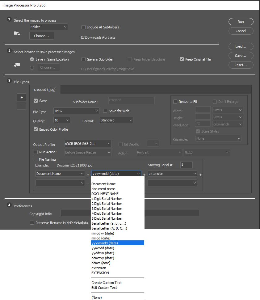

A Script can rename a file anyway you want as well as it can save a file with any file name you want. You would need to pass the parameters you want the script to use.  This is normally done using a ScriptUI Dialog.  You would be able to set the folder to process in the dialog or have a select folder button  in its the dialog you can use select the folder to process. You cans also set the Image file type or types you want to process in the folder.  You can  set Date suffix you you  added to the file names then click the dialog's run button.  The thing is you most likely do not know how to script Photoshop. That is why I suggested the image processor pro plug-in script you can download and install it from the web.   However,  its dialog does not have a way to filter the image files types to process. I will process all Image files in  a selected folder.  However, it can be used from the bridge where you would select just the Jpeg files you want to process in the Bridge's UI and then you would use Bridge's menu Tools >Photoshop>Image Processor Pro...  Photoshop will open and Photoshop will open Image Processor Pro's Dialog where you will set Image Processor Pro dialog to process the files selected in the Bridge  and have it save  Jpeg files in the same folder and use your custom Date file name suffix you set in the Image Processor dialog.  The thing is the jpeg file will be a copy there will two jpeg file with identical content in the folder with different names.  It not a rename.  If you want to add things to the jpeg You can record an action to  add what you want to add to the jpegs and have the Image processor pro include using your action when processing your selected jpeg images.
Tp add data set up an action toe add the dats to the jpeg. ANy the set to Image Processor Proo.. dialoy toe user it.

Community Beginner ,
Oct 12, 2021 Oct 12, 2021
Thanks You!
I realized it wasn't loading my font at all when I messed with this. Does the font have to be ttf? and not otf to recognize the name? The name in font book is "Graphik"
If that font is installed on your system the name you use in the script has to be its internals postscript name not "Graphik"
Graphik Font Free Download  I have not idea of what its postscript font name is.
