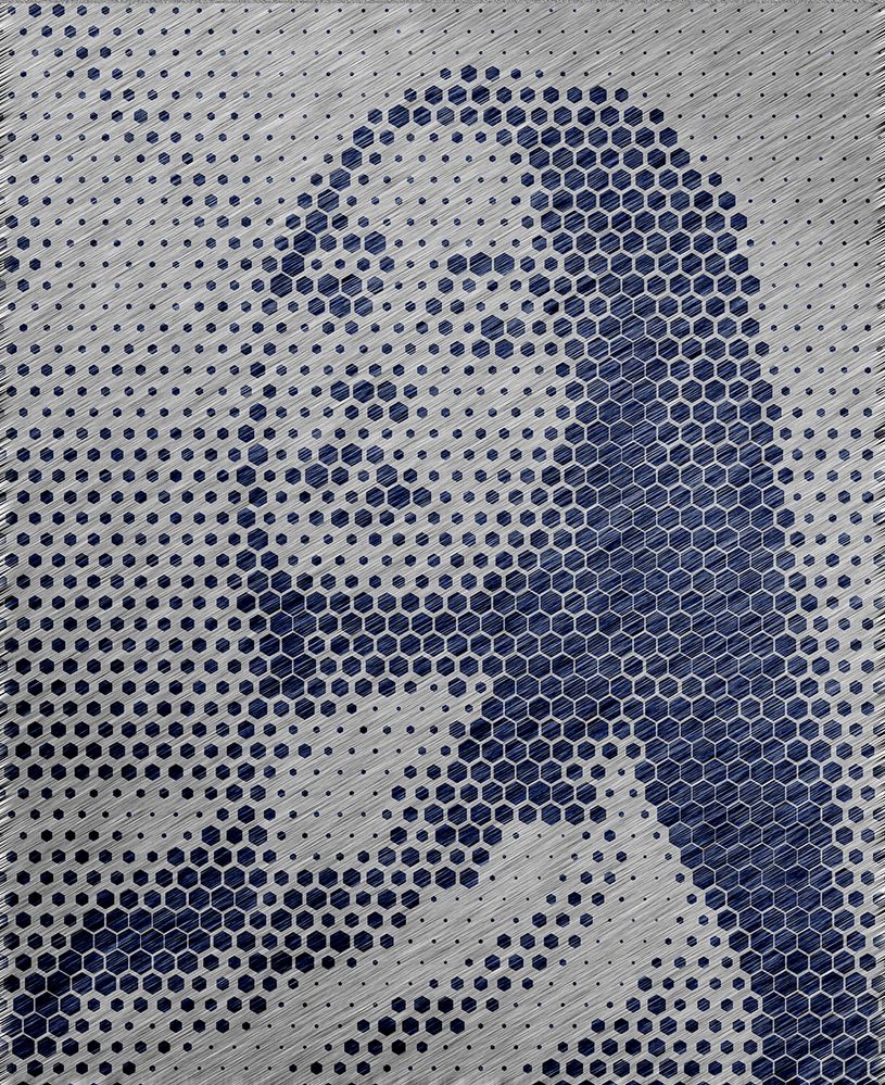

You can do it with the deco fill scripts and my custom UI for it: http://uebelephoto.com/CS6_Fill.html

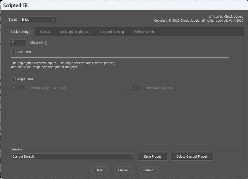

First, you need to set the offset to .5 under the Brick setting tab. This will stagger each row by half.

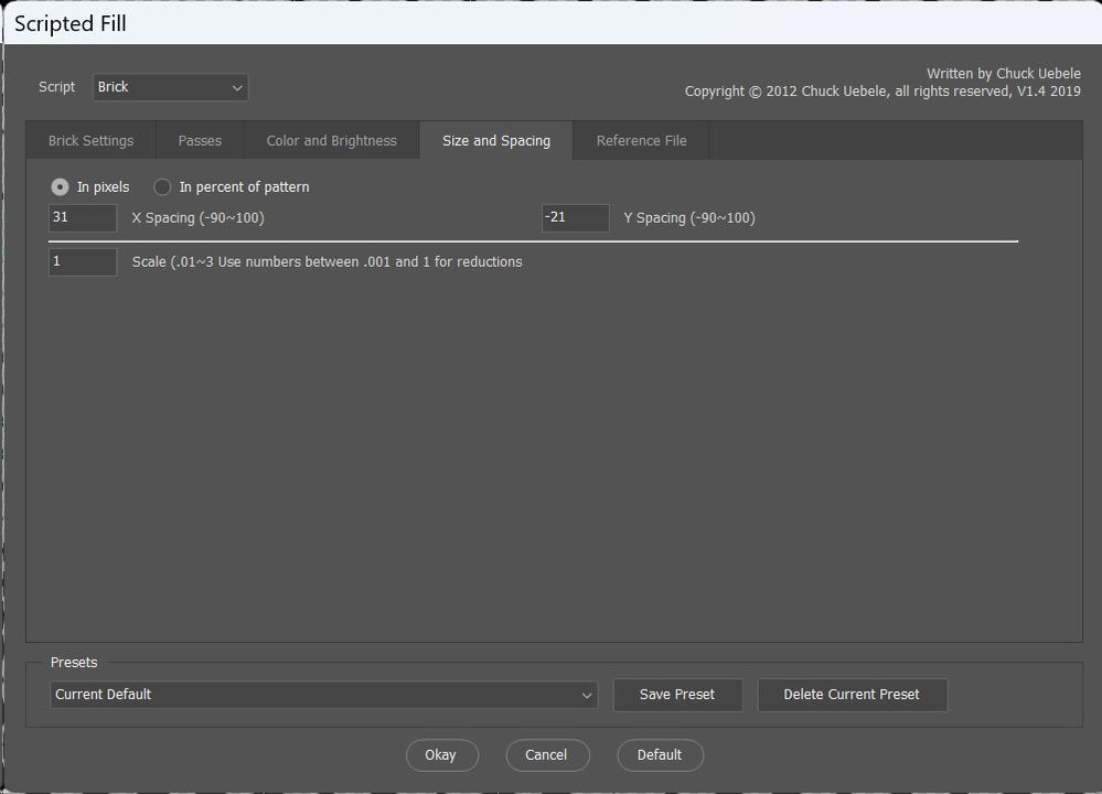

Then you need to adjust the spacing. Don't worry about making a referance file at this point, just just the fill so that you can adjust the spacing. I used a X spacing of 31px and a Y spacing of -21px

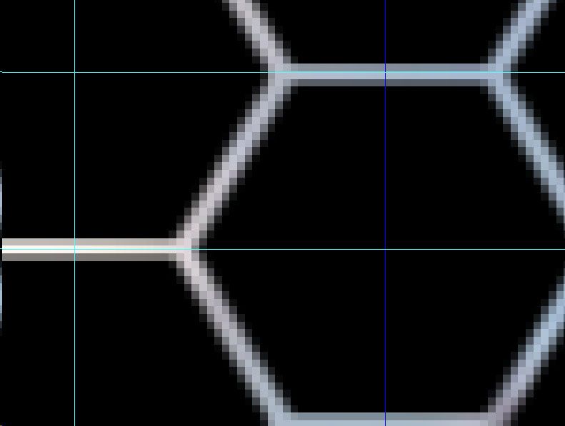

Next using your test for spacing draw some guides between the enters of the hexagons to get the spacing for your referance file. I used 41px X 24px.

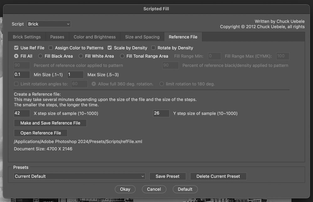

Then enter that number in the UI and click on "Make and Save Reference File" Depending on how big your file is and how small your pattern is, this can take a long time to generate, so be very patient!!!
Once your reference file it done, click on open reference file and open the file that you just created. Click on "Use Ref File, and select, "Scale by density."
Then hit okay. the fill dialog will come up. select script and the script is TempFillScript. Then select your pattern.

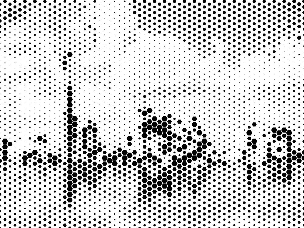

Here's what mine turned out like:

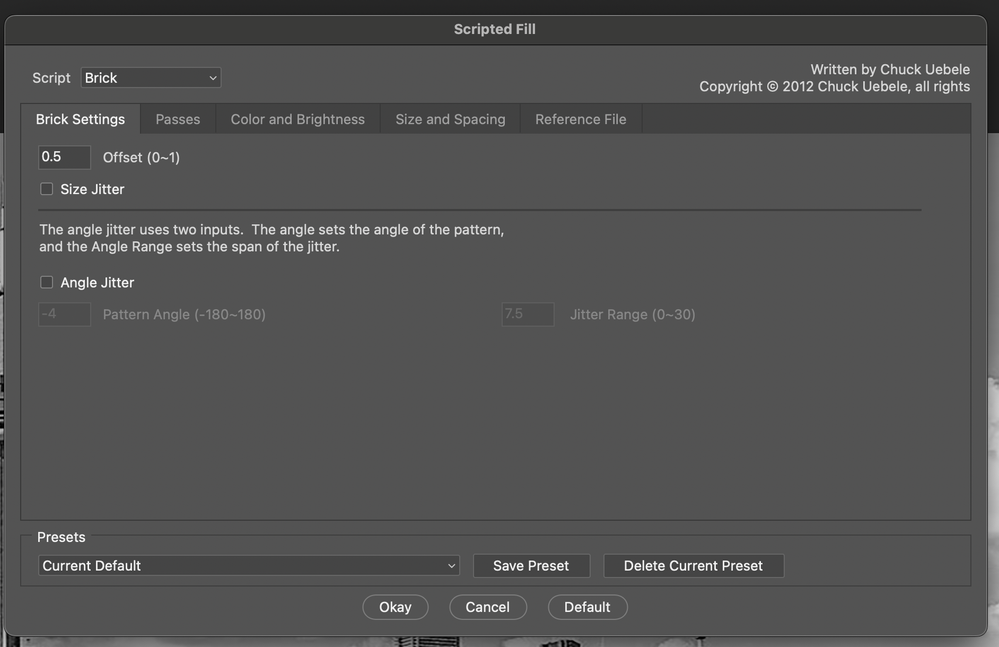

Screenshot 2024-07-12 at 4.10.21 PM.pngScreenshot 2024-07-12 at 4.52.20 PM.pngThen my brick settings:Screenshot 2024-07-12 at 4.10.31 PM.pngScreenshot 2024-07-12 at 4.52.40 PM.png
Upon pressing "OKAY" it takes me to this pop up, where I have filled in the correct custom pattern, but Brick is the only script selectable. Screenshot 2024-07-12 at 4.53.31 PM.png
After clicking okay there is takes me here. I don't modify anything and hit ok:Screenshot 2024-07-12 at 4.57.38 PM.png
Then I get this, which is obviously not what I am hoping for... and is just seemingly the custom pattern done in brick style:Screenshot 2024-07-12 at 4.57.53 PM.png
