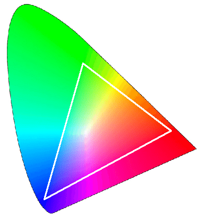

I work with textiles and am working on a project to reproduce near-exact fabric color swatches online. I cannot get RGB/Hex web colors for high saturation blue-greens or green-blues that are found in many fabrics. In fact, the hue zones in between green and blue go very weak (low saturation) in the PS color picker tool. Has anyone else run into this problem also? Do I need to use another system other than HTML colors? Has anyone been able to successfully "grab" high-saturation blue-green/green-blue hues from your photographs to reproduce in a browser? Thanks, Michael

If you can't get to that color on screen, it's out of gamut for sRGB. It's outside the sRGB color space and can't be reproduced.
Your display has a gamut, a range of reproducible colors, that is roughly similar to sRGB. There are displays with wider gamut, but these are usually expensive and most people won't have that.
You can work with colors outside sRGB in Photoshop if you use a bigger document color space like Adobe RGB. However, you can't see them on screen. You should also be well experienc
You can work with colors outside sRGB in Photoshop if you use a bigger document color space like Adobe RGB. However, you can't see them on screen. You should also be well experienced with basic principles of color management to do that, because it has a lot of practical implications you need to be aware of. Otherwise you quickly get into trouble.
This is sRGB. As you can see, the cyan/blue range is where the gamut is most restricted:

1. Turquoise fabric isn't uniformly colored. The reproduction requires
many different shades. The reproduction doesn't require extremely
saturated colors, because textile colors are surface colors and therefore
not narrow-banded  (in the spectrum).  Examples:
https://www.whitelodgefabric.com/turquoise-fabrics.html
2. Viewing these examples on a calibrated monitor (near sRGB), these
colors are for me sufficiently saturated and in many (other) examples
far beyond "average" acceptance (disputable, of course).
3. Web safe colors are just a subset of RGB colors.
Six Values 0, 51, 102 153, 204, 255 in each channel, which delivers 6*6*6 =216
combinations or simply "colors" if we refer always to sRGB.
No need for this restriction. Monitors near to sRGB should be assumed,
which delivers for values 0,1,...,255 altogether 256*256*256=16.8 millions
of colors.
4. How are the available sRGB colors looking on an actual monitor?
Just show pages 19 – 21 of this doc:
http://docs-hoffmann.de/swatch22112002.pdf
Of course they don't look like the illustration in the horseshoe diagram #3,
because darker and less saturated colors are there not shown.
5. Regarding the fact, that all kind of textiles are already available on-line,
the task is neither useless nor hopeless. It can be expected, that monitors
will be further improved in future.
Of course I acccept opinions like Dag Fosse's  #5 or TestScreenName's #6.
6. Other objections, besides lack of calibration, are varying viewing conditions,
not only for the monitor but also for the cloth (metamerism).
That's really a wide field...
7. For professional applications true fabric samples are probably helpful.
https://www.pantone.com/fashion-home-interiors
Best regards --Gernot Hoffmann
