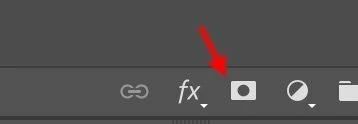

 by pressing alt/opt then clicking on the mask icon, at the bottom of the layer panel, you can create a mask that is filled with black that hides the entire layer. Then choose the brush tool and white as the color and paint the thick stroke areas back in.
September 5, 2022
Dude you are amazing thank you.
This way is super effective and useful for me.
