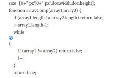

size=[0+" px",0+" px",doc.width,doc.height];
function arrayComp(array1,array2) {
    if (array1.length != array2.length) return false;
    i=array1.length-1;
    while {
        if (array1 != array2) return false;
        i--;
    return true;

The script as it is right now has an :information: emoji on line 21. If I change nothing and just copy-paste the script, I get an error. If I put (i>0) instead like so:
i=array1.length-1;
while (i>o) {
then Photoshop freezes upon exe executing the script.
Could you please help me find the reason it fails? Is it in line 21?
Thank you!

I am looking for a way to automatically match colors in a picture using curves adjustment layer.
In a post from 2014 on this forum I found a script by @jugenjury that is supposed to do exactly that. Unfortunately, a number of symbols turned into an emoji in the original post so the script "as is" is not usable.
I figured, there must be a value for "i", but if I put (i>0) or ((i+1)>0) instead like so, and try to run the script, Photoshop ends up freezing.
i=array1.length-1;
while (i>0) {
i--;
return true;
Does anybody know where the problem might be?
I'll put the whole script in the first commentary below as it is quite long.
Mar 28, 2021 Mar 28, 2021
Where is the script that a small segment of a script you need to download the full script. the statement was most likely
while i;
for some reason you got a icon for the  "i;"
What you posted is  size an array top left bottom right of the document the  The function look to see if two arrays have the same length and the while sees if the element are the same.  However, I not see the  elements being selected using i as a index into the arrays.  the two [i] seem missing.  But I only hack at scripting I can be wrong.
JJMack
Community Beginner ,
Thank you very much!
For some reason I can't post the whole script as a reply.  Just wouldn't go.
I just tried "i;" and got a syntax error...
    i=array1.length-1;
    while
        i--;
    return true;

The problem I am talking about is in line 39. Currently it's "while i; {"
Thank you!
The while statement should be
while (i) {
However the script seems to loop before the function is used,  I had to kill PS.
here is hoe I changet the statemt.  I also added an alert in the beginning of the function when PS hung the see it it was caused bt the fubction.  However PS hung before the function was used.
JJMack
Yes, thank you!
This is where I found the aforementioned script.
The problem is, one symbol in it has turned into an emoji which makes the script unusable...
