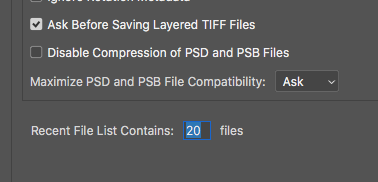

Hi D,
Then this is strange because I re-installed Photoshop—having also deleted Preferences files—and Compression is on by default (see attached)—explains the 15-30 second long save and open times; and despite that I get the size-savings with a white layer.
An undeniable categorical fact. I should know, I've done it often enough. I'm curious now to see if don't use compression how huge my billion layer illustration files will be.
The interface is weird, in effect: Click the checkbox to disable compression (which must be on by default), but I understand it. It's not like some I.T. nonsense speak like 'Deselect to un-disenable non-compression.'

OK, I think I see it now.
'Maximise Compatibility' is the thing that puts up the file size hugely—and (on a mac at any rate) creates the preview image. If it's switched off, you get a blank white preview. Fair enough, you don't get increased versatility for no cost.
To get a smaller file with 'Maximise Compatibility' still on, use a white layer. It works.
But, if 'Maximise Compatibility' means it'll display in an InDesign layout when imported, or some other application, it'll be for nothing if there's a white layer on top. I don't know what else 'Maximise Compatibility' is useful for. Maybe Lightroom or something... I never use that.
So if there's any point in ever having a PSD with 'Maximise Compatibility' enabled, even though there;s a white layer on top, then go ahead and do it, to save space.
