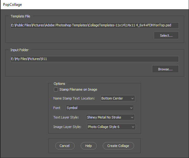

Nov 08, 2020 Nov 08, 2020
I do not know ScriptUI  I just copy paste parts of dialog I fine in script Adobe installed with Photoshop or
ones I have downloaded from the web many from appends made here  that work one my machine. Here is a dialogs from my collage populating script. It Has one checkbox I include the Scriptui  Dialog statement to add the checkbox and the code the uses the checkbox. I did not have to initialize the checkbox I just declared its variable .st and checked it
