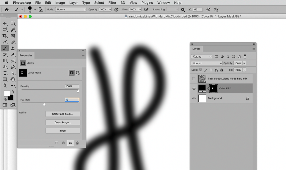

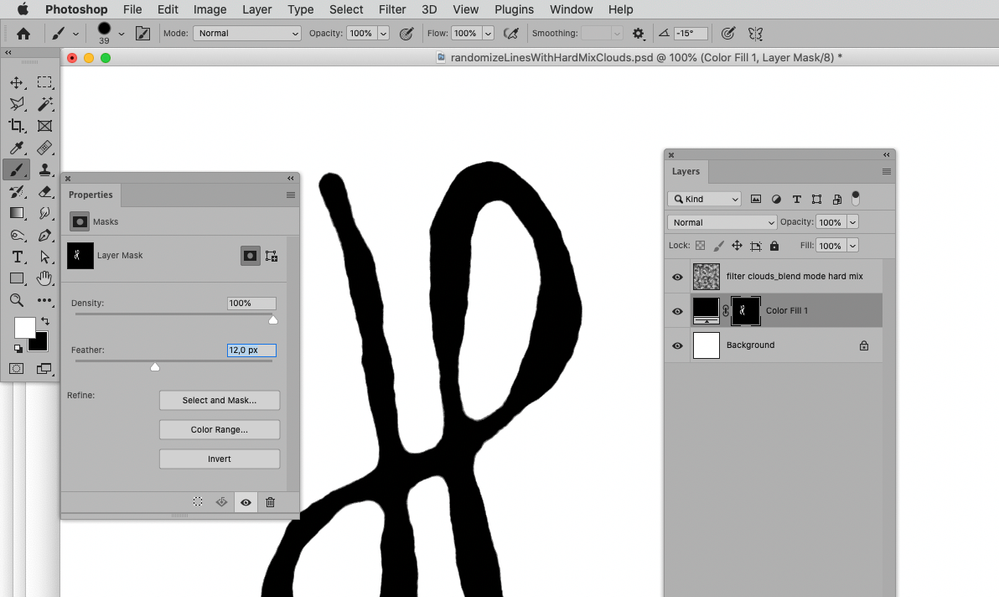

A somewhat complicated option would be a Solid Color Layer with a Feathered Layer Mask and a Cloud Layer with Blend Mode Hard Mix (at a slightly reduced Fill).
Screenshot 2023-02-11 at 15.02.11.pngScreenshot 2023-02-11 at 15.02.20.pngScreenshot 2023-02-11 at 15.02.26.png

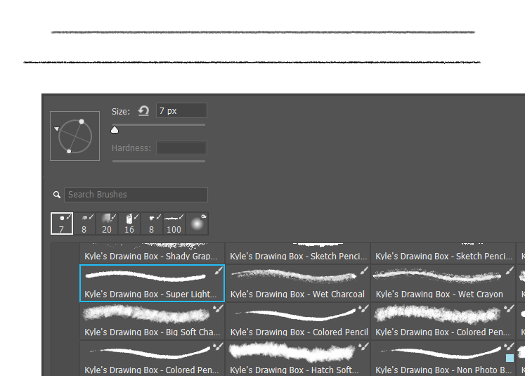

There are some nice presets in the Kyle Megapack.  Load it if you don't already have it, (from the Brush panel options)
...and use the search tool to look for 'Sketch'
