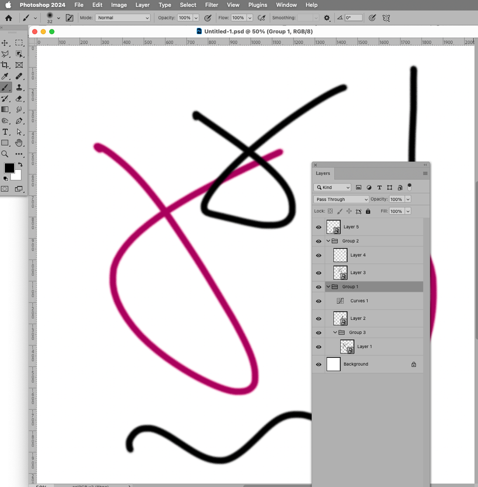

Hello
I am currently facing a situation where I have multiple groups containing multiple smart objects, adjustment layers, type layers, and more. I am in need of a script that can select all smart objects within the group for which I'm currently selected. I have searched for a solution and come across some options, but none help my problem. I only have basic knowledge of JavaScript and also try to use Chat-GPT but it also doesn't work.
If anyone knows please give me a solution. thank you very much

Your previous screenshot didn't show the selected layers highlighted.
It would help if you explicitly stated what you wanted to do once all the smart object layers in the target layer group were selected.

Ah, nested groups which also contain smart objects...
Once they are all selected, what next???
Copy link to clipboard
Copied
Yeah, next i want them to scale down individually but keep there axis using a script from "kami" but now i have to chose them one by one, sadly haha
