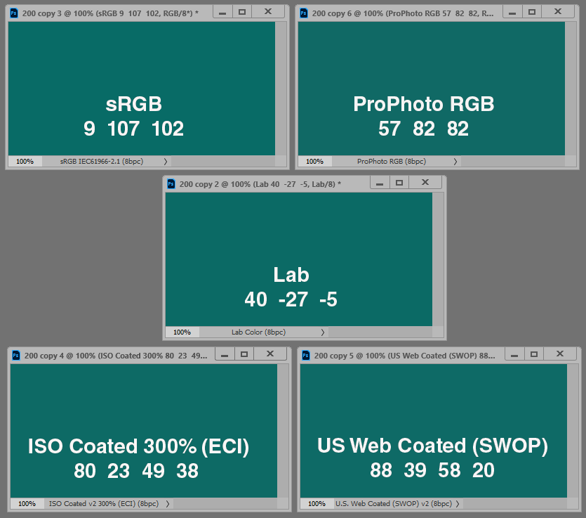

Aug 28, 2021 Aug 28, 2021
Photoshop doesn't "interpret" anything. There is a fixed reference throughout all of this, and that's Lab.
All color management is based on Lab. That's why it's used as Profile Connection Space (PCS) in profile conversions. Photoshop conforms to standard color management specification and procedure.
NCS codes should also refer to Lab. So again, you have a bedrock, a center of the color universe, and all other numbers are satellites to that. There is no particular magic to any of this. You just need to know the color space, and then the color is absolutely defined and identified.
Open this image in Photoshop (make sure the sRGB profile is embedded), and try the color picker. They will all read as Lab 40  -27  -5.
There is only one precaution that you need to take, and that is to stay within the gamut of the color space. A given color can't be reproduced in a color space if it's outside the gamut boundary (the clipping point for any color channel). But that's a universal concern unrelated to Photoshop.

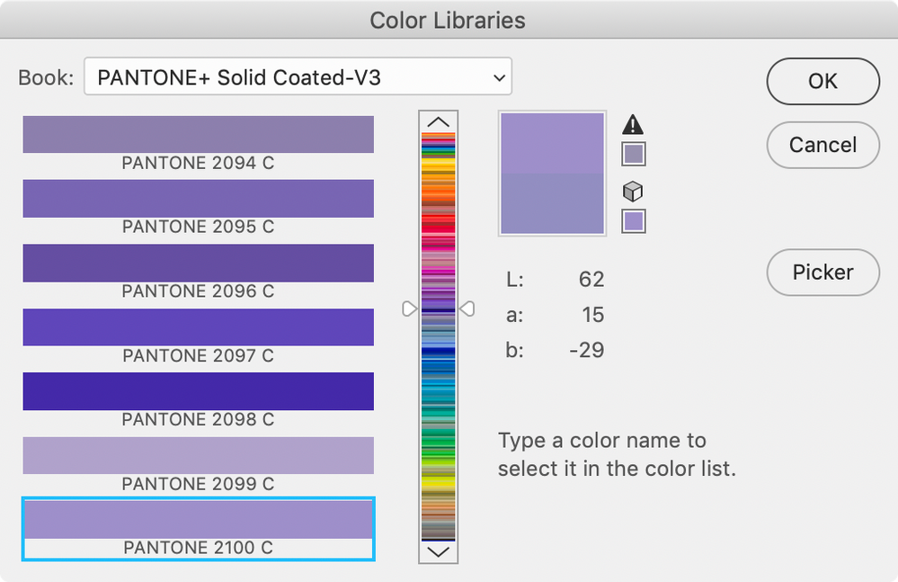

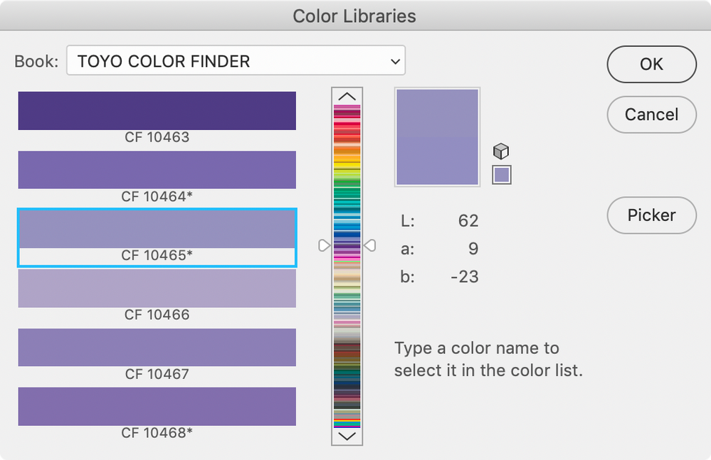

Also, if you have an NCS Lab value you can find the closest color in other solid ink systems via the Color Picker’s Libraries. For example if the solid color is Lab 61|10|-26 I can get Pantone’s closest coated solid color (2100C) or Toyo’s closest coated solid color (CF10465):
