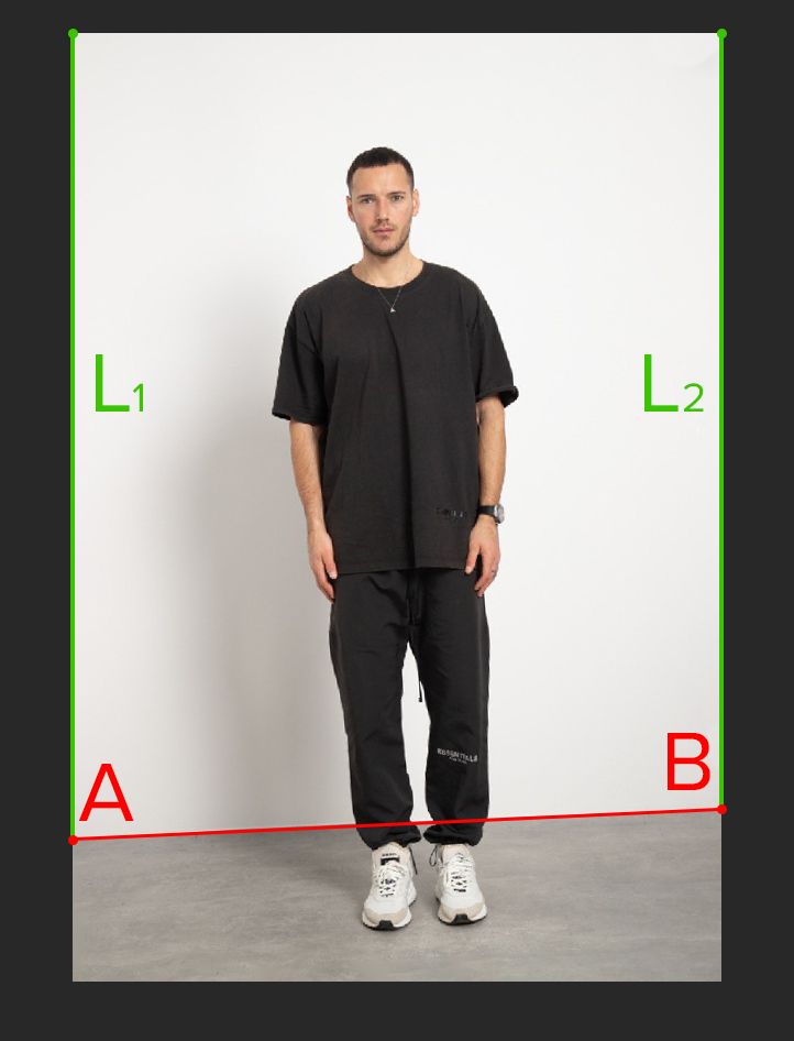

I do not know how to work with java script, but I have some ideas.
If there are people here who understand this, tell me if it is realistic to implement, or am I mistaken)
Here's my guess:
1. To align the image, we need to find 2 points, connect them with a line, and find out what is the angle between this line and the horizon. This value will be the angle by which we need to rotate the original image.
2. A similar method, we find 2 points and compare the distance from them to the edge of the canvas. The scrip should find the difference in distance and rotate the original image by half of this difference? (L1-L2)\2.
"I'm very bad at geometry too :), so don't judge me harshly."

Participant ,
Jan 12, 2023 Jan 12, 2023
I think there are many ways in which we can find the extremes of "A" and "B."
For example:
1. Cut out the image inside except for a few pixels on the sides.
2. Using channels and levels to achieve a mask. Remove everything except the floor parts. And with the help of selection, make a stroke around these areas. As a result, we will have vector points, the coordinates of which can be used to calculate everything we need (?).
That's like the first option I had in my head to find vector coordinates, maybe I'm wrong about something.

Jan 13, 2023 Jan 13, 2023
quote
By @Andrew Bold
Your ideas sound reasonable, but don't forget that we are limited by the runtime environment. Photoshop's scripting environment severely limits our ability to analyze images.
There are several ways to solve your problem, but all of them have some disadvantages and depend heavily on how the rest of the images will be similar to the samples you provided.
I follow this logic:
  1. In order not to waste time on channel-by-channel processing, we translate the image into grayscale
  2. We get two full-height strips with a width of 1 pixel on the left and right of the image
  3. Save each strip to a separate raw file
  4. Read the brightness of the pixels from these files
  5. We assume that the composition of the rest of the shots is similar to your samples: 80-90% is the wall, the rest is the floor. We sum up the brightness of all the pixels in the strip and find the average. Since the wall takes up most of the image, the average brightness will always be closer to it, and the floor will be different.
  6. Find the color difference of each pixel between the average brightness value of each strip and build a bit mask based on this (1 - the color is different, 0 - the color is not different)
  7. Since the floor is always below, we count how many pixels from the bottom differ from the average (with an error margin of no more than 5 pixels in a row)
  8. As a result, we get two points - left and right, find the angle between them and rotate the image to it
The script is not perfect, but it works well with the examples above.

Participant ,
Sir, this is awesome! 🤩
I tested the script on 10 photos and it worked 100% of the time. It works even with a different background (There's a wooden floor and a gray wall).
I admire your skilfulness! It works much better for me than the standard Photoshop and Lightroom methods.
I am very grateful to you! 🤗
I really regret that I don't have the knowledge to do such useful things.
As soon as I will have time, I will test this script on a lot of pictures, then I will be able to describe my impression and tell about errors (if any).
Mentor ,
There will certainly be errors. The algorithm will fail if the contrast between the wall or floor is low or if there are large objects on the wall or floor that are very different from the general background, however I hope that my code will allow you to correct most of the photos.
