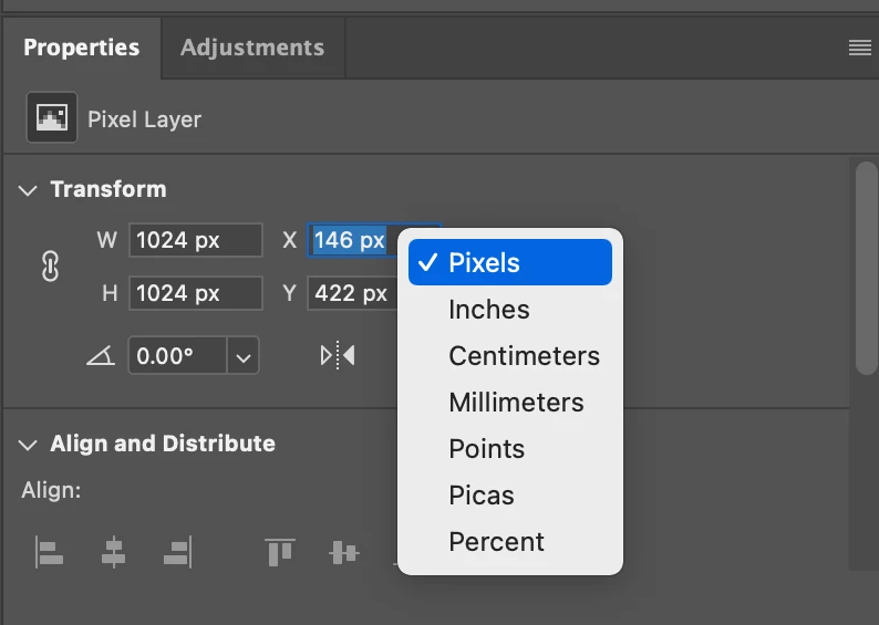

Apparently Layers have sizes because you can resize them with a free-transform box by selecting a layer and doing a Ctrl-T.     But how do you see - in actual pixels, cm, or some other units - the actual size of a layer in the first place?  And where can I set the size of a layer by typing in a value?
I want to create a set of layers of very specific size and placement.
Thanks in advance.

OK, but how do I get the size from that?   Remember, my goal in this thread is to read and set the size of various layers.   Mouse-over says that X and Y are positions.  And W just says 100%  so how to you read or set the size from that?
As I wrote:
"You can right click in the X/Y or W/H fields and change the unit of measure..."
The properties panel reflects the unit of measure set in the ruler tool. Double click on the ruler or right click the ruler to change the UoM.
It is also worth keeping in mind the type of layer (raster, vector) and how resampling settings may affect the resize.

Another way to see what is going on, which may be easier to understand, is to use CMD/CTRL + T and then look at the options bar at the top of the screen.

I looked at the ctrl-T option but they just give an offset, not a size.  Also I don't want to use a free-transform; I want to trype in specific sizes for my layers. I don't want to be playing around with scripts -  I want to use the native Photoshop tools.   The Windows > Properties one looks promising but the documentation in the 2019 manual is out of date so I don't know how it works.

I would still suggest transform, it offers the most information and offers more control.

You can right click in the X/Y or W/H fields and change the unit of measure, or override the current unit of measure by adding a unit to the end of the number being entered. The transform reference point can be changed. The W/H fields can be linked proportionally or unlinked for distortion.
The Properties panel uses a fixed upper left reference point for resizing, one can override the current unit of measure by adding a unit to the end of the number being entered. Physical units of measure are absolute, while % based is relative to the current size.

Look in the Properties panel - transform section

I found it but I don't understand what I'm seeing.     How does it work/where is it documented? (attached image)
