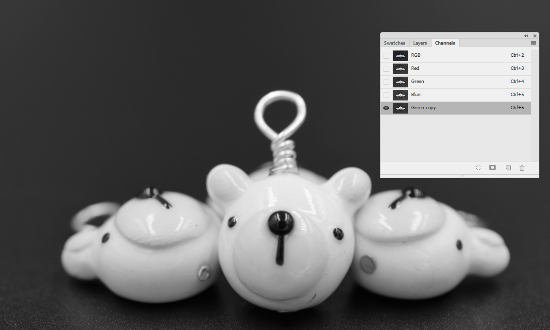

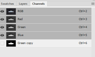

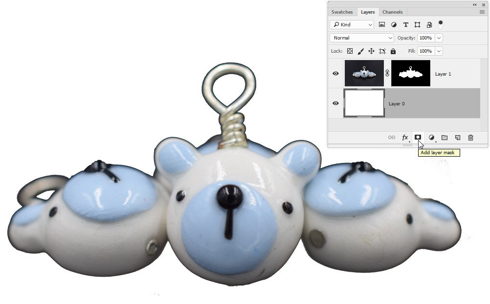

There are many ways you could approach this. The edges of the object are kind of blurred, which makes it more difficult.  I would use the Pen tool to draw around the shapes. that would give a nice clean edges. However, it can take time to get the hang of the Pen tool.
Another option would be to look at the individual channels in the Channels panel. You would look for the one with the most contrast, which seems to be green in this case.
Duplicate the Green channel.

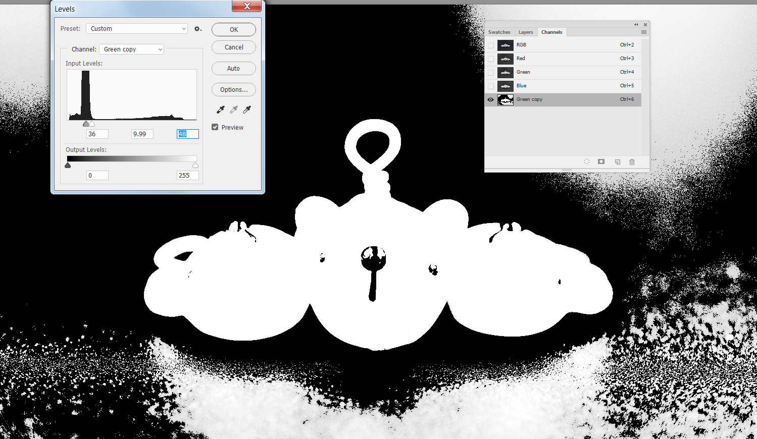

With the Green copy channel targeted, choose Image > Adjustments > Levels. Increase the contrast to get good black and white contrast around the objects, especially on the edges. Click OK.
Use the Brush tool, selecting a hard-edged brush (not one of the brushes with soft fuzzy edges.)
Paint with black and white to touch up the channel.
Make the RGB channel active.
Ctrl (WIndows) Command (Mac) click on the Green copy channel thumbnail. This will load a selection of the green copy channel.
In the Layers panel, click the Layer Mask icon. Then add a new layer underneath that is filled with the color you want for the background. Below I filled it with white.
Because of the fuzzy edges on the photo, a black fringe remains around the edges.
Click the layer mask. It should get a subtle double line around it when it is targeted. Choose Filter > Other > Minimum. Increase the radius until the black fringe is gone.
With the mask still active, use the Brush tool to touch up the mask: black to hide areas and white to show areas.
The job of removing the background will be easier if you take take the photo with crisper edges. Try a higher number on the F stop for more depth of field, and try getting further away from the object when you are photographing it.

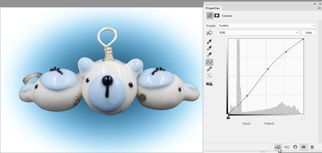

If that's not possible, you could try using a darker background or gradient to try to minimize the problem edges, like this:
With a darker background it wouldn't hurt to use a Curves adjustment layer to bring out more contrast in the objects.

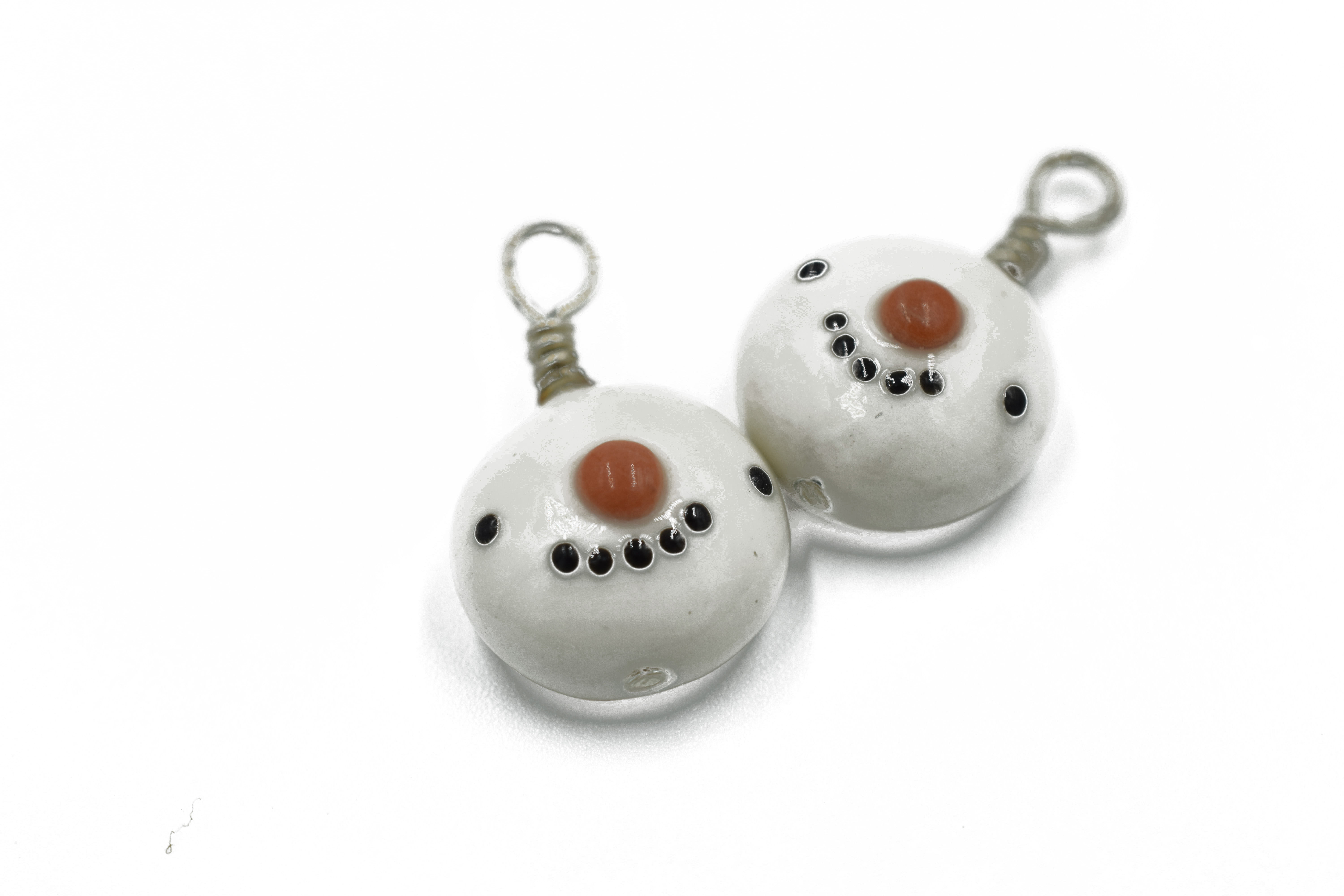

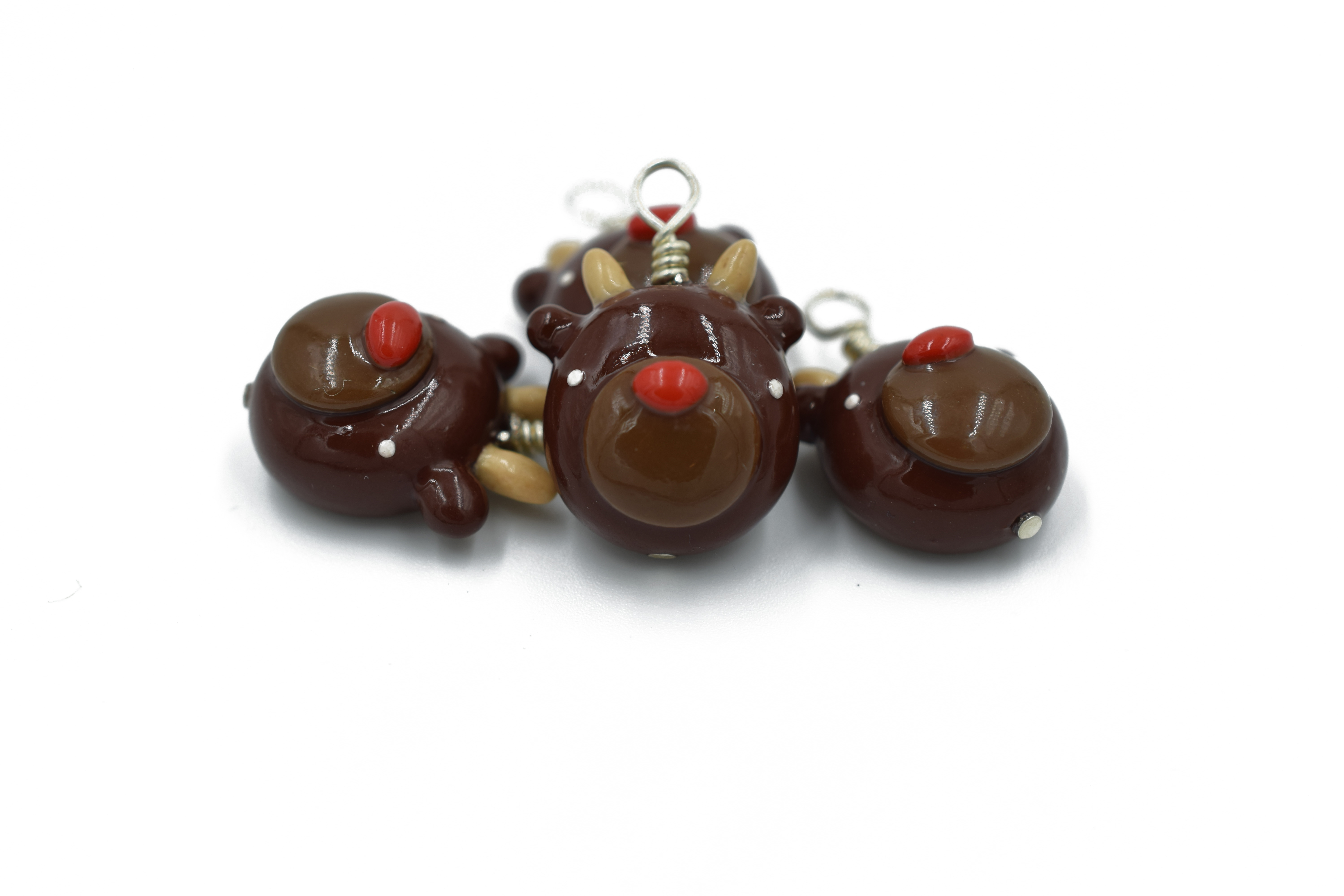

I tried using a white background like with the rest of my photos, but, unfortunately, if the products have white in them, they are changed when I try to adjust exposure. Here are some examples:reindeer1.jpg
I was able to edit the background on these reindeer no problem because they have minimal amounts of white in them. However, when I try to alter the background of a white-containing photograph, like this one [unedited]:
It ends up like this:
See? it makes my product look filthy and wonky.

Hi

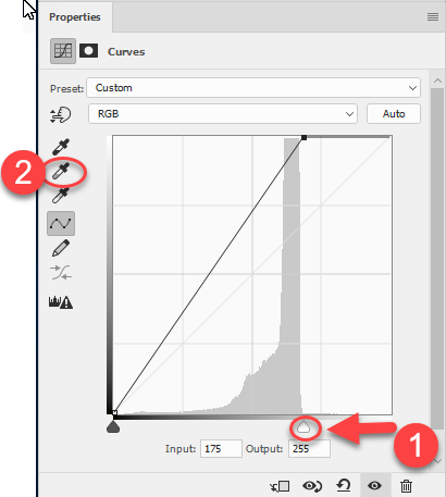

That last image can be done with a curve. Add a curves adjustment layer, click on the lower of the three eyedroppers and click on the white area of the image
Dave
Community Beginner ,
Nov 18, 2017 Nov 18, 2017
Thank you so much.
Do you have any way of going into more detail? I'm only a beginner, so I don't know what a curve is or how to make one, etc.
Sure the steps were very simple.
1. Open your image
2. In the adjustments panel click on the curves symbol. This will add a curves adjustment layer
3. In the layers panel, click on the curves layer and go to the properties panel
4. In the properties panel click on the third eyedropper down
5 Click on your image in the white area of the background
Dave

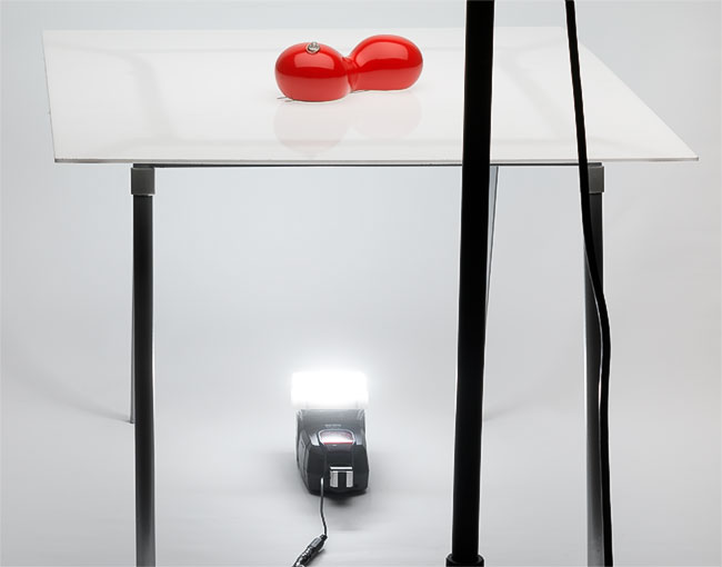

In the future, if you want your images to stand out, you could try backlighting in combination with a soft/diffused main light. It's not as complicated as it sounds and is fairly easy to set up:
This does not produce the same effect as masking out the object, because the backlight is reflected in the object itself. So you get a "floating" effect where it almost looks like it's hovering in mid-air.
Here I used a large soft box as the main light, because I wanted a sharp and defined reflection. You can see it in the red surface. In other cases a light-tent, producing fully diffused "white-out" light will give a better result.
Yeah, it's a weird looking red blob, but this is out of context

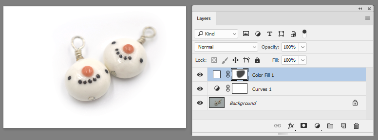

is there any way to ensure that my background is pure white? After going through some of these images, I've realized that the backgrounds look whitER, but not perfect white.
Nov 19, 2017 Nov 19, 2017
Hi
You could follow the actions in the previous post with careful masking and a further curves layer, but I would just do the following:
1. Add a white color fill layer above the curves layer
2. Click on the mask
3. Take a soft black brush and paint over the image (you are actually painting on the mask).
That method gives you a soft transition between the white immediately round the objects and the white at the edges of the image frame
Dave

If you get an image where the automatic click with the white eyedropper overdoes the adjustment then you can drag the white triangle to the left manually.
Then click with the middle eyedropper to white balance the image
Dave
